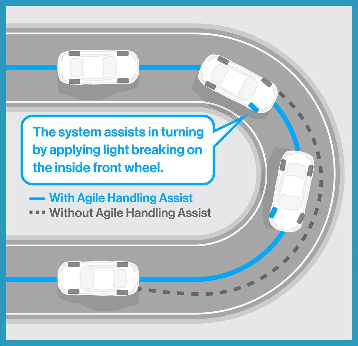

AHA from my understanding only works on the inside front tire

What wheel size and tire were you on? I noticed the G-meter hitting 1.3 g's right before the spin took place. You were coasting down a hill initially, but you spun at the crest of a hill that you were ascending. I'm fairly certain AHA only has an effect on the front brakes. I had something weird like this happen to me before, but it only resulted in me spinning off into the grass, and hitting nothing. In that scenario I believe I ran through coolant, which I could not see on the track surface.
I also listened closely to the sound of the tires, and to me it sounded like it was the rear tires that were making the squealing sound. You can hear them start to squeal before they let go entirely. Possible that they were greasy too depending on how hard you were hitting the track prior to slowing down to head to the pits.
I'm inclined to say that you experienced lift off oversteer even though you were coasting at the time. Basically the same exact thing that happened to me just at a lower rate of speed. Judging by all the tire marks there, I would hazard to say that this particular corner is extremely tricky.

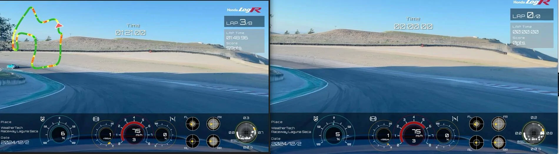

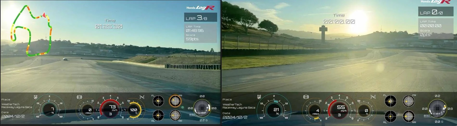

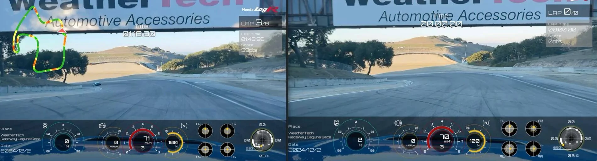

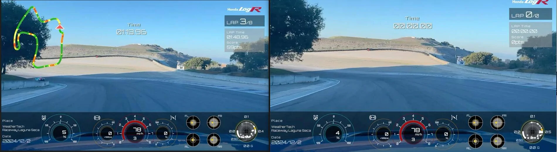

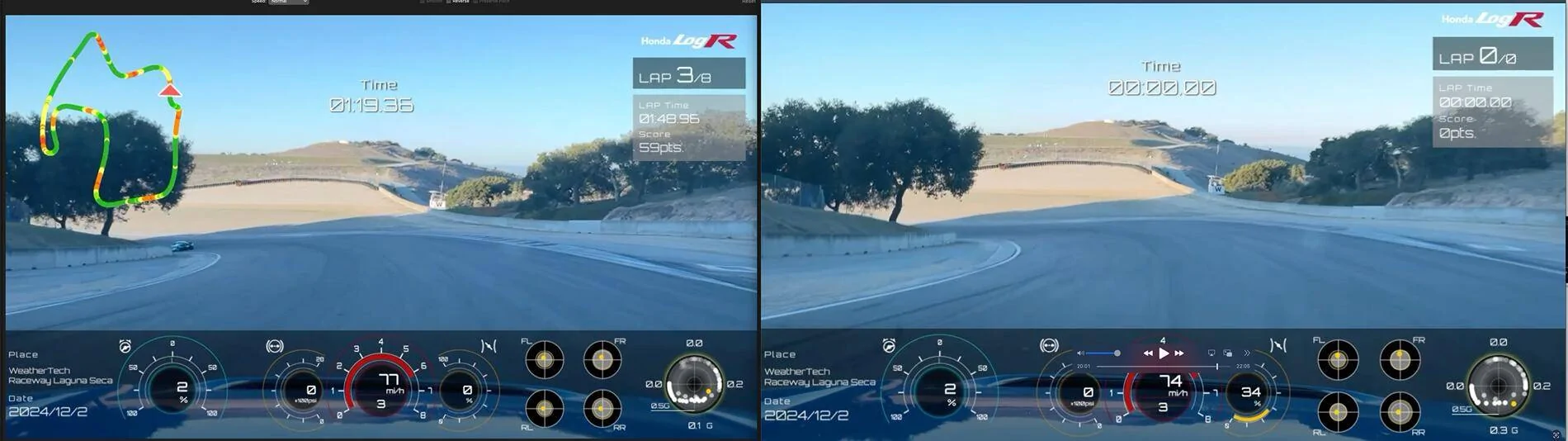

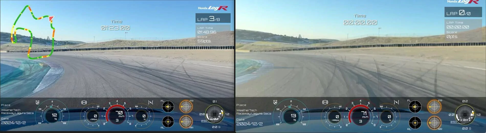

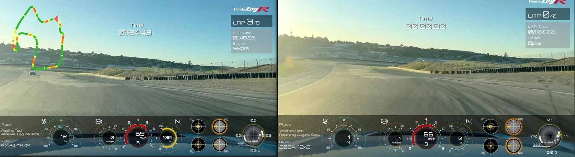

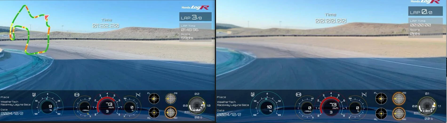

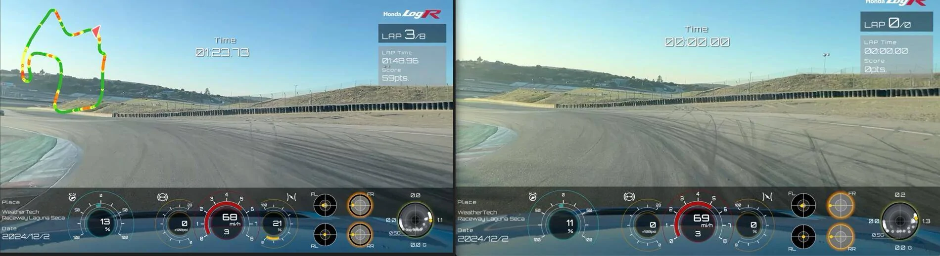

Here is the play by play comparison. Pedal Dance On Left - AHA ( Long Press +R ) on right
I was chasing down the Mclaren driving more aggressively with pedal dance on the left.
It's almost identical, I even have more of an aggressive steering angle with pedal dance vs AHA ( R+ long press )
If I had gassed on AHA ( +R Long Press ) the car would have been fine - It was too aggressive for me as the gas pedal is connected to torque vectoring using brakes. Its braking rear to turn in. That caught me off guard as I was used to the natural dynamics of full pedal dance.
11th Gen Honda Civic CIVICXI *NOVICE* Track Thread! spin1
11th Gen Honda Civic CIVICXI *NOVICE* Track Thread! Spin2
11th Gen Honda Civic CIVICXI *NOVICE* Track Thread! Spin3
11th Gen Honda Civic CIVICXI *NOVICE* Track Thread! Spin4
11th Gen Honda Civic CIVICXI *NOVICE* Track Thread! Spin5
11th Gen Honda Civic CIVICXI *NOVICE* Track Thread! Spin6
11th Gen Honda Civic CIVICXI *NOVICE* Track Thread! Spin7
11th Gen Honda Civic CIVICXI *NOVICE* Track Thread! Spin8
11th Gen Honda Civic CIVICXI *NOVICE* Track Thread! Spin9
PointByPatrol
PointByPatrol
Ben
Jul 28, 2023
2,022
3,205
It's almost identical, I even have more of an aggressive steering angle with Long Press vs AHA ( R+ long press )
I have analyzed these slides and have an opinion, but had a few questions.
1. What did it feel like when it happened?
2. Tire and wheel combination?
3. How many laps had you completed before it happened? (what were your lap times?)
johnloov
John
Jul 9, 2024
453
502
happened?
It felt like day and night compared to my previous laps, but the rear just caught. I knew it was aha, that touched my rear brakes. It felt like someone independently touched my brakes in rear without my permission!
I was coasting for 6 seconds no throttle no braking, it felt like the car touched my rear brakes as I turned in and no throttle no braking. My understanding is this is exactly what AHA does it uses the throttle pedal to steer trying to emulate a rear wheel drive car.
stock tires 4s rims - camber pins out. 2mm toe out total. ~38 psi hot front and 35 hot rear nitrogen filled ( helped stability of tire performance )
3. How many laps had you completed before it happened? (what were your lap times?) lap times no traffic ~1.47,1.48, 1.49 ~ 7 laps
Pulled into pits engaged long press / base line was all day pedal dance
then spun it, pitted again - I want to see what the difference was right away while car was hot tires were hot
back to pedal Dance ran it again….
No spin……
I’ll be back at Laguna Seca in 2 days. Will test again and again. I feel more natural with pedal dance, even though I understand a AHA can make you faster. I currently have no problems with understeer in my car so I don’t understand why I need it.
