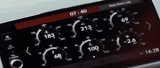

These are my temps during my 3rd session after 2 hard laps. Ambient temp was around ~60F. I only installed the CSF radiator in terms of cooling mods.
