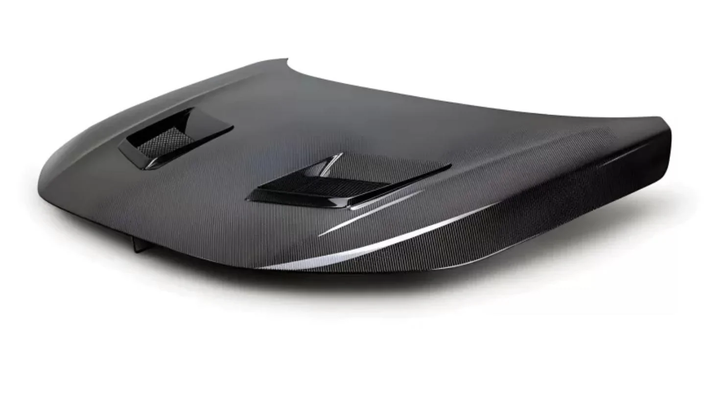

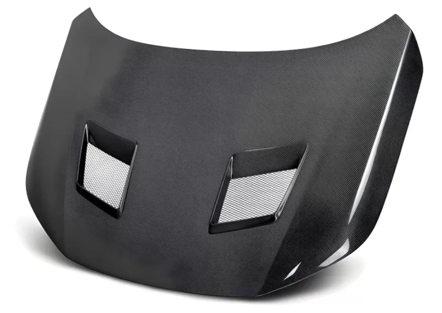

did you receive this hood? im thinking of getting it.
It traveled from china to Florida, then to Brazil WITHOUT A BOX lol
and arived unharmed.
here is a video of it at the import company:
Now It has to move anotehr 600 miles to arive at me, wich is a pita because freigh companies here are the worse.
it looks great. did it fit well? ill probably get it as soon as my car is lowered.

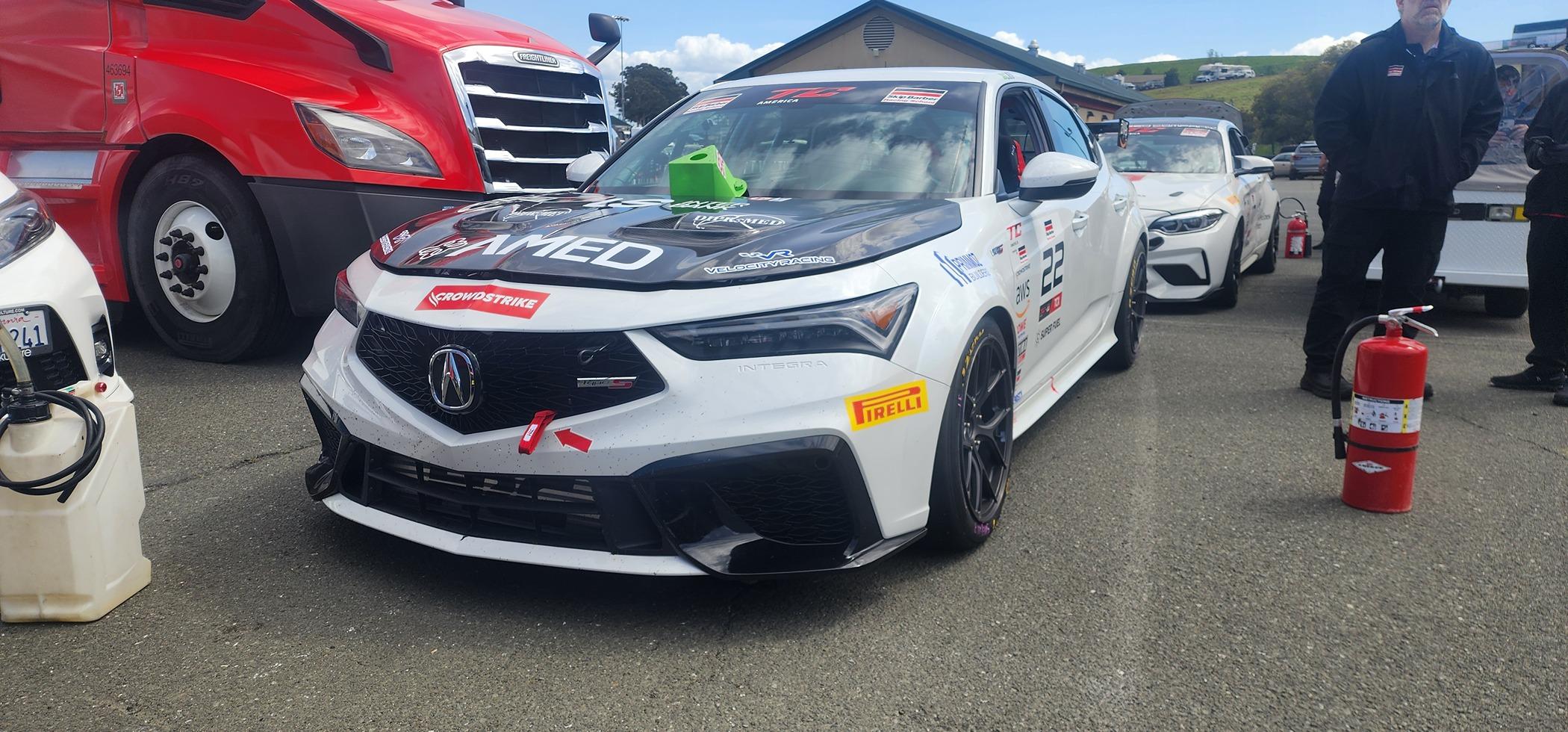

The HRC DE5 tcx car developers seem to agree considering they are using a dual oil cooler set up along with a PWR race radiator with no AC condenser, as well as a seibon vented hood.
can you share the link of where you got this? im going to get it as well.
have you installed it yet to your car?
