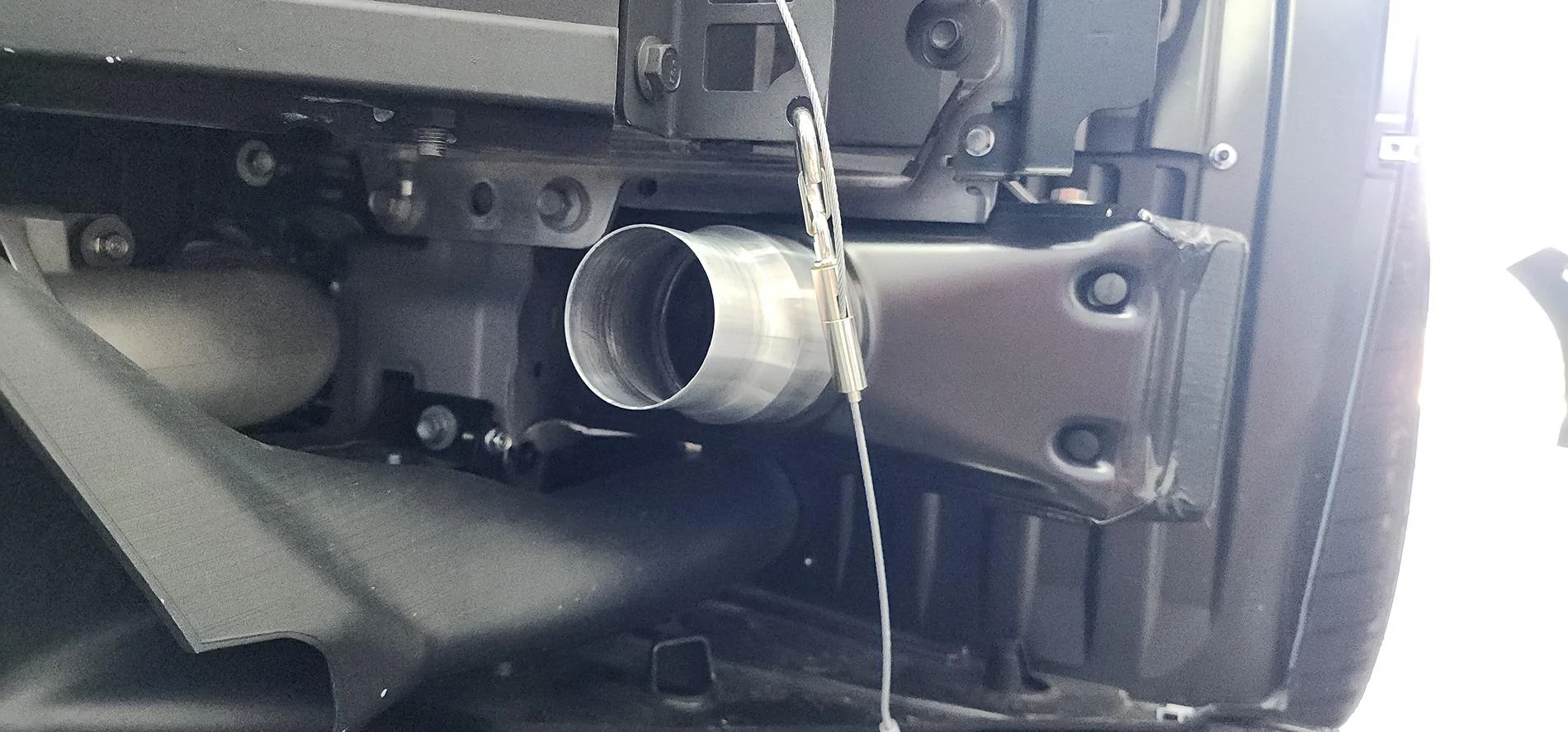

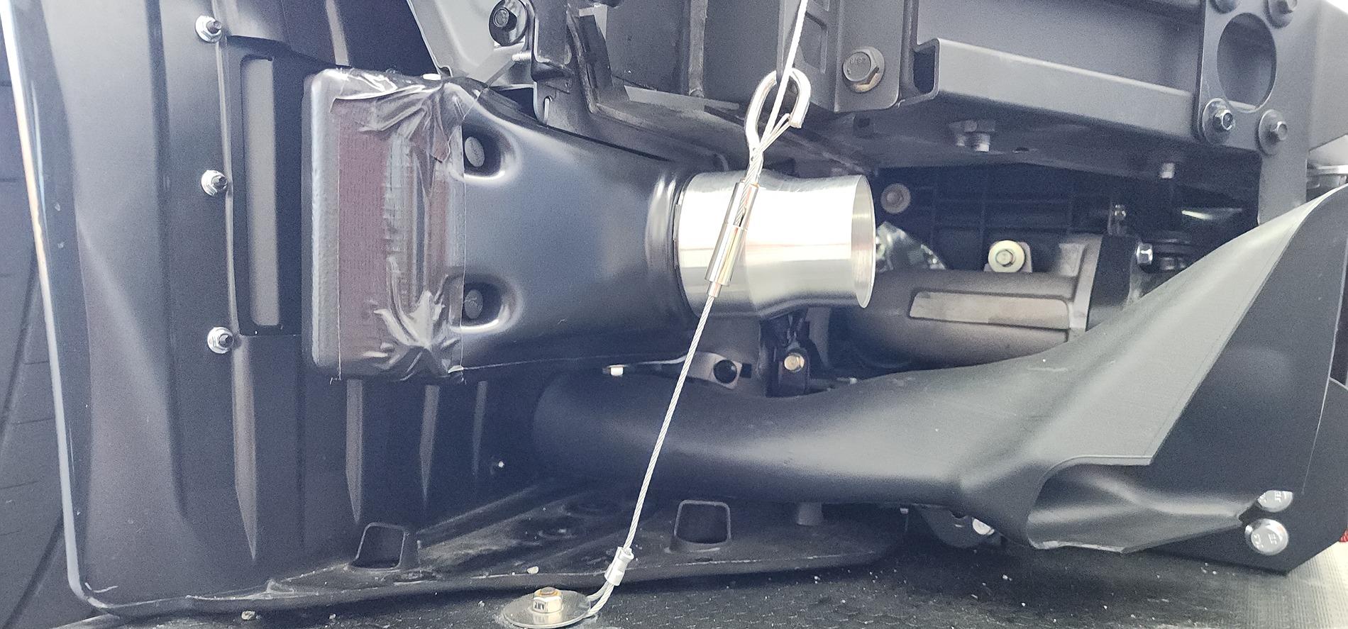

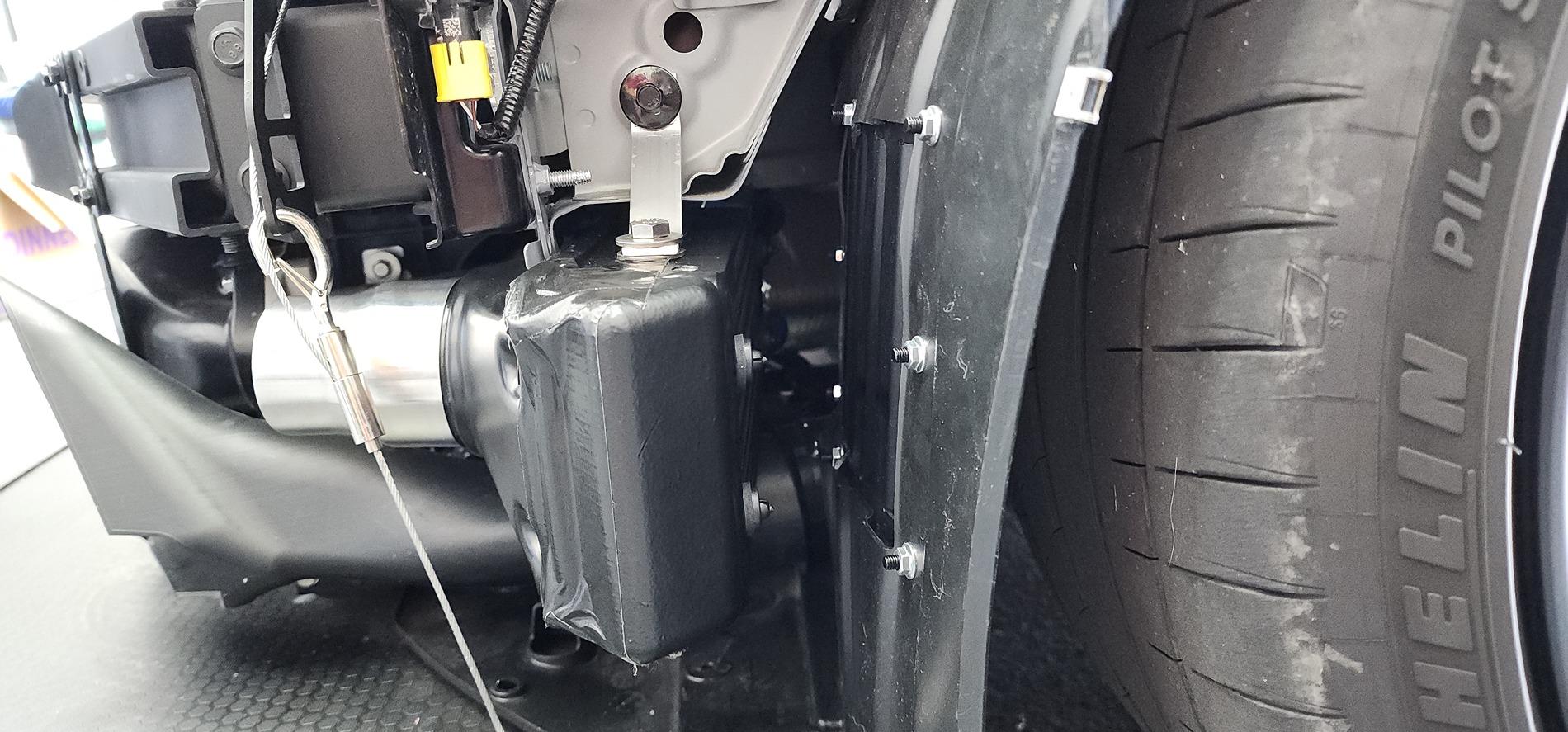

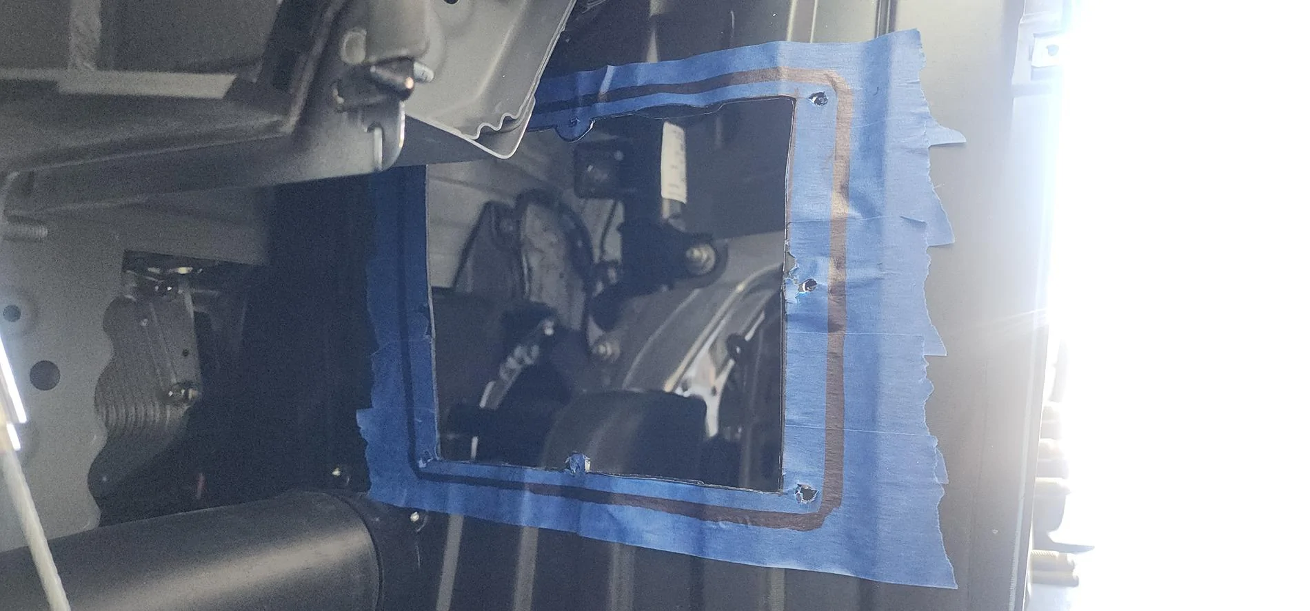

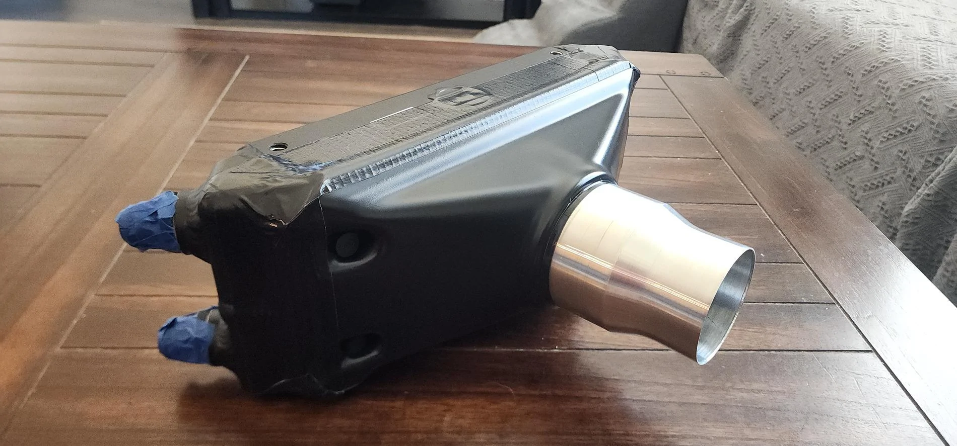

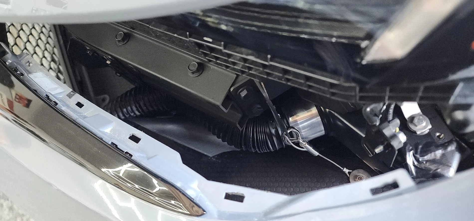

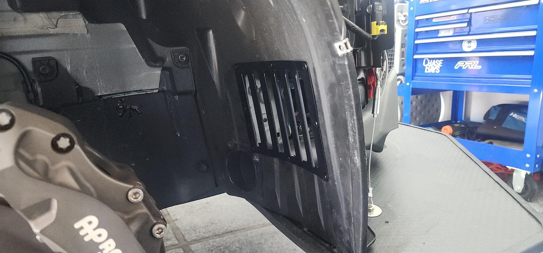

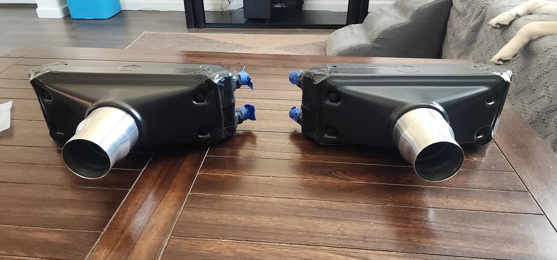

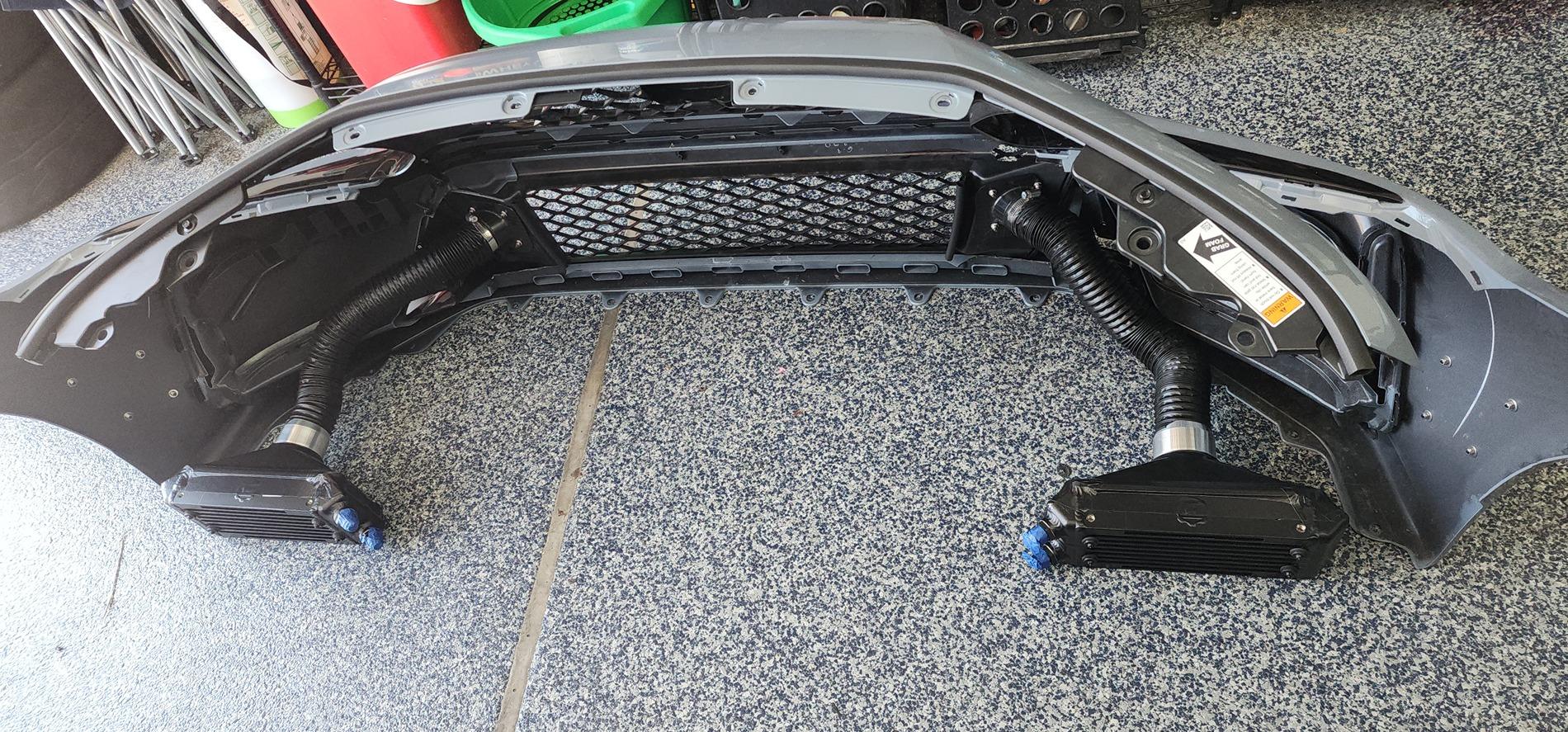

So happy with how this is turning out! Dual oil cooler set up is 95% complete, just need to receive the sandwich plate and link up the lines tomorrow.
The fitment of the various pieces is as good as I could have hoped for. Really looking forward to getting it fully operational tomorrow and then testing in this 100°+ weather. Only question remaining is should I do them parallel or in sequence?
Parts list:

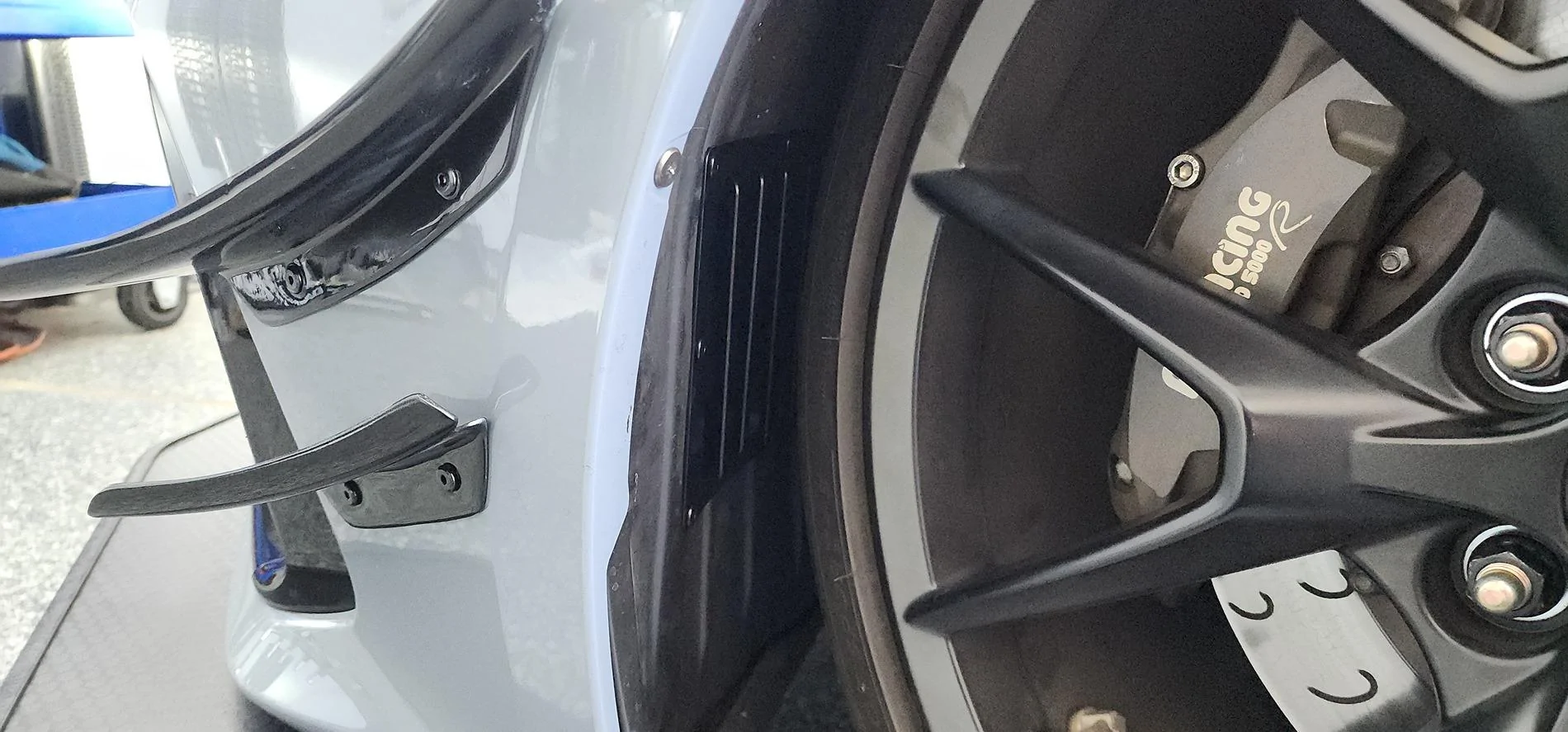

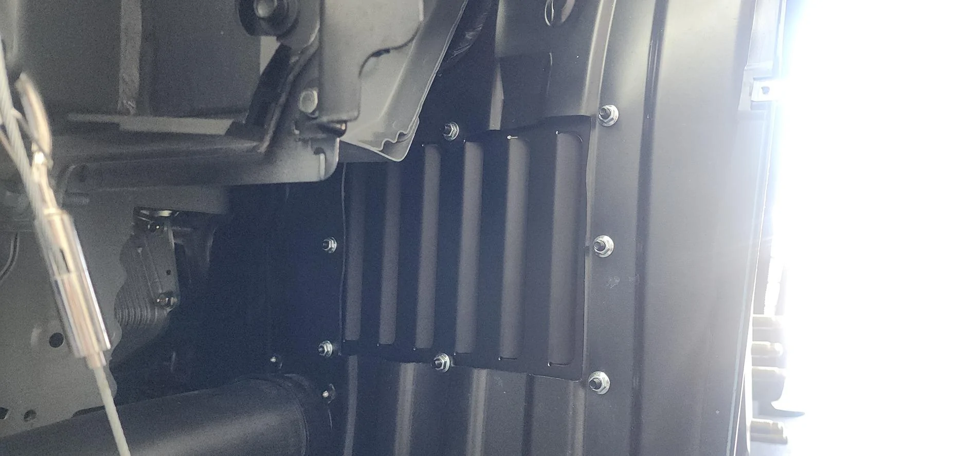

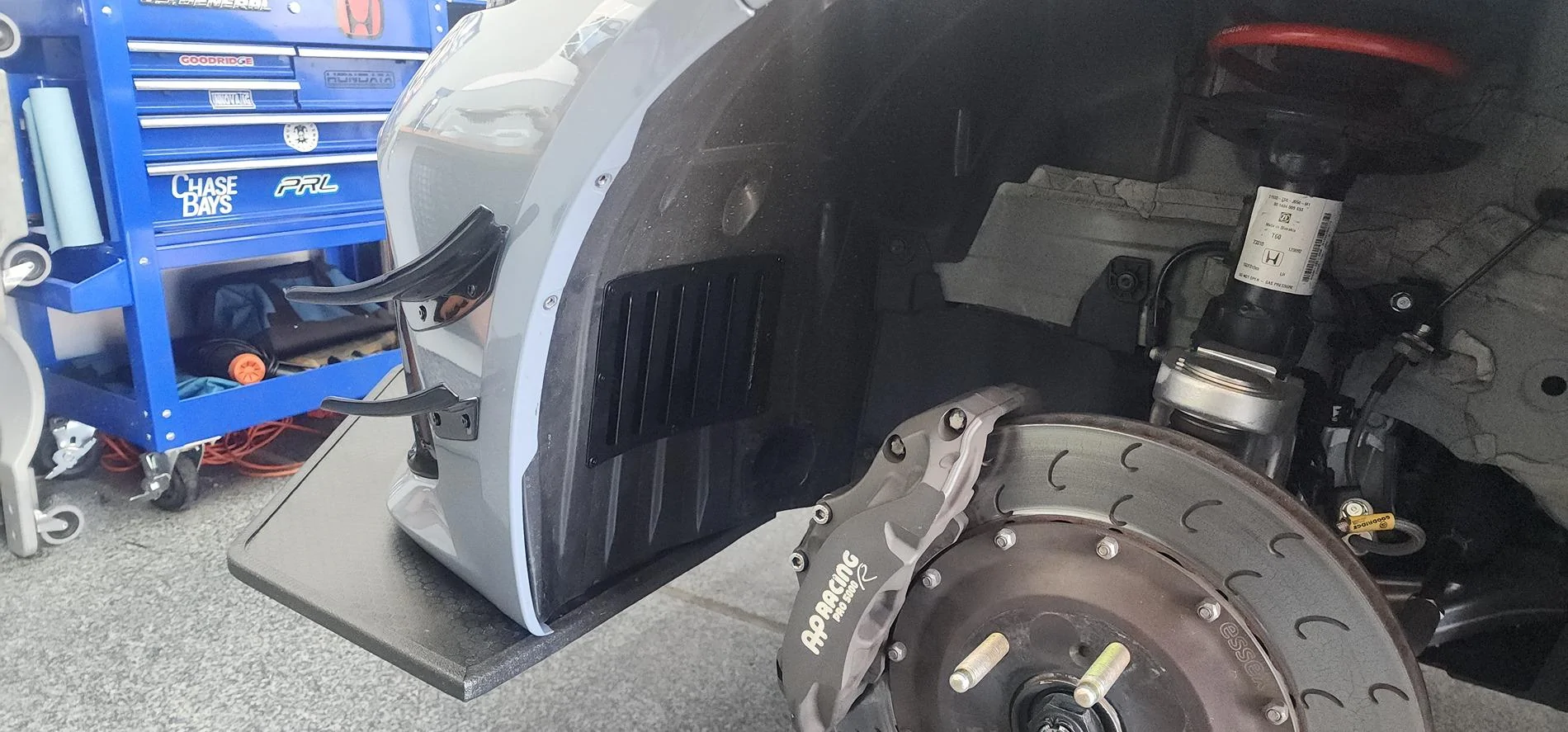

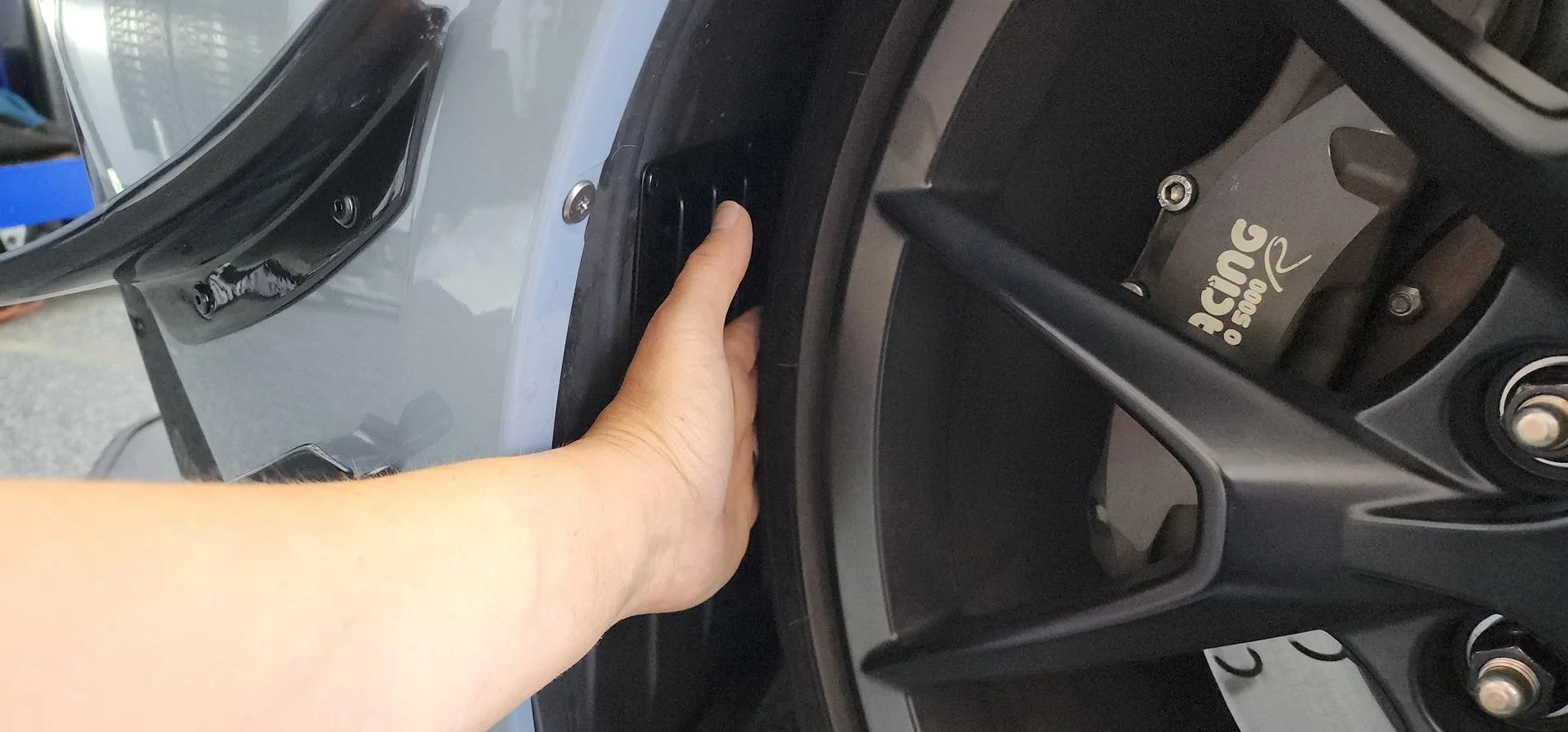

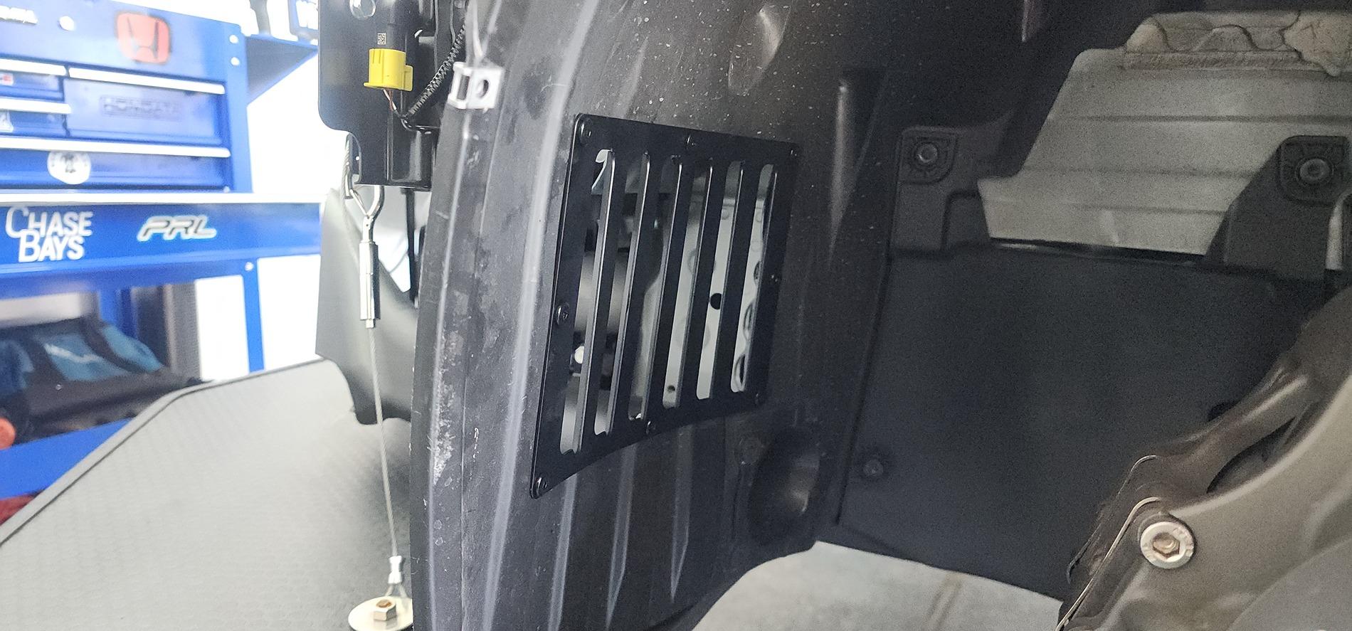

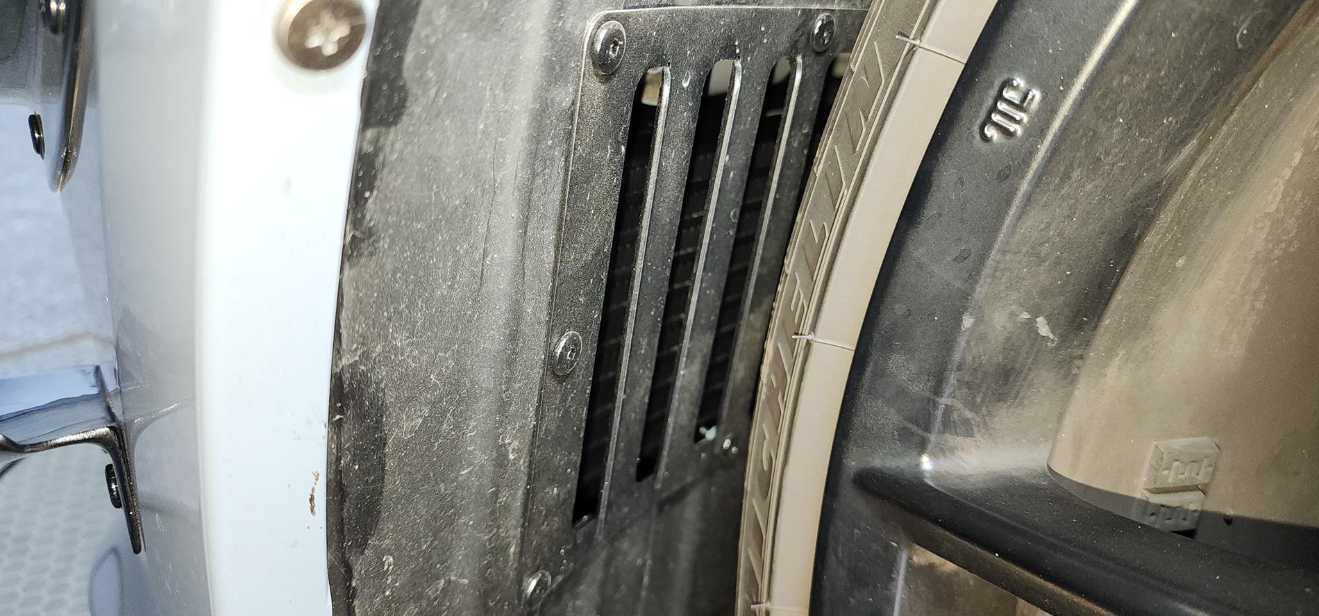

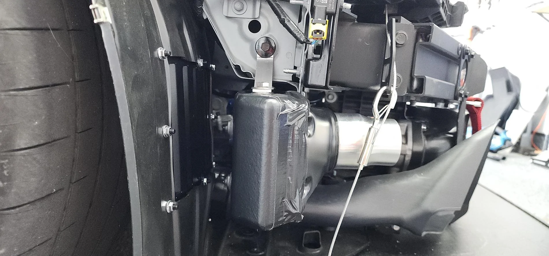

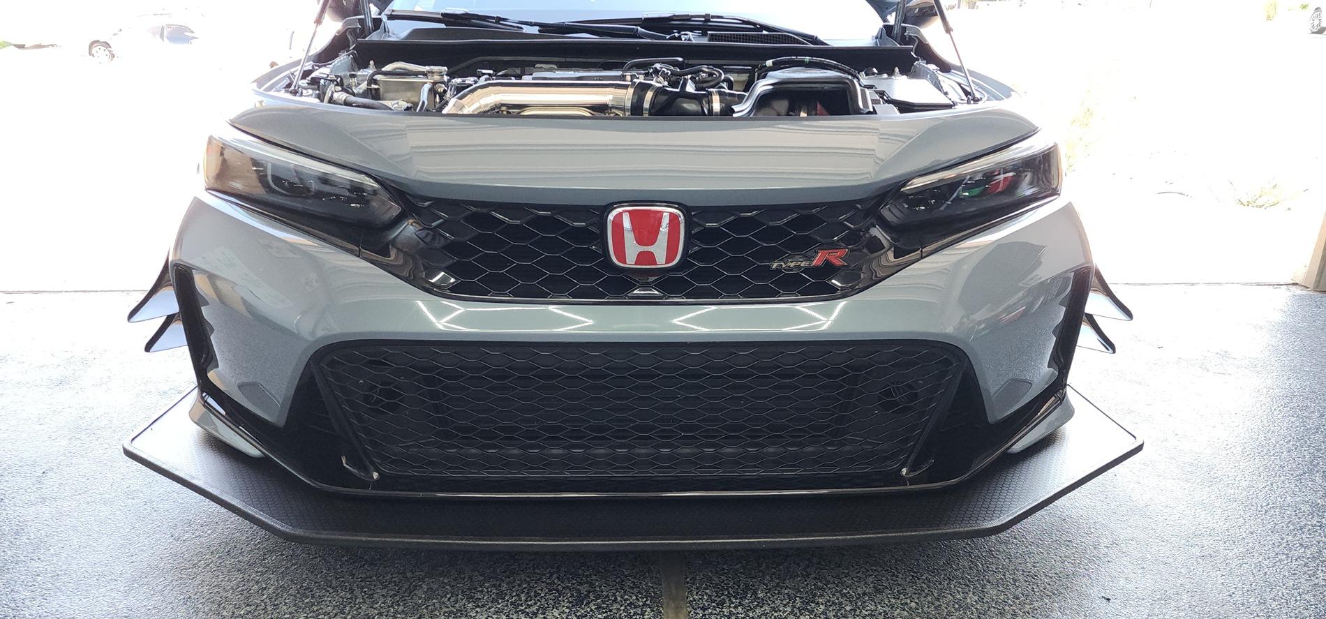

Wow that looks amazing. Its really great that its separated so that it wont impede any airflow to the radiator. Also those vents on the fender are really ingenious. I believe you mentioned that you were going to do a secondary radiator at some time any ideas on where that will go?

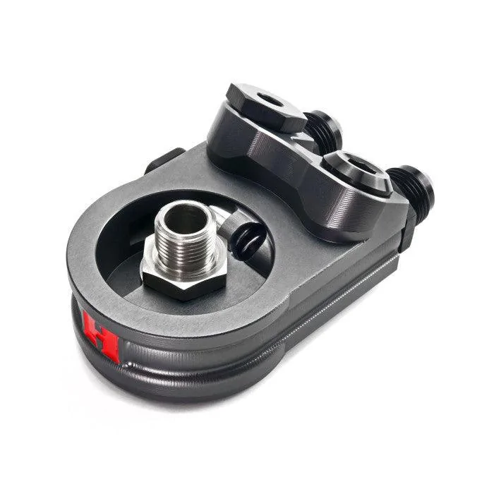

Any reason why you went with the HEL sandwich plate instead of the GReddy?

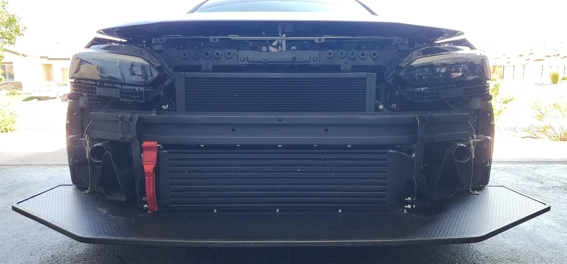

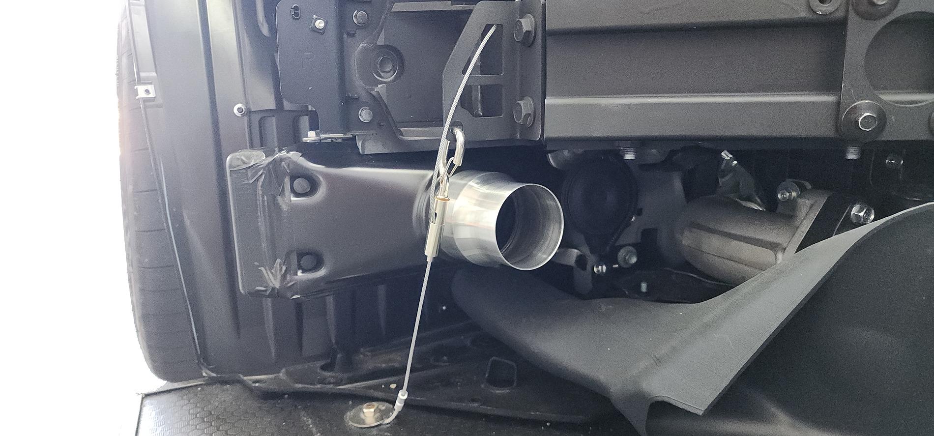

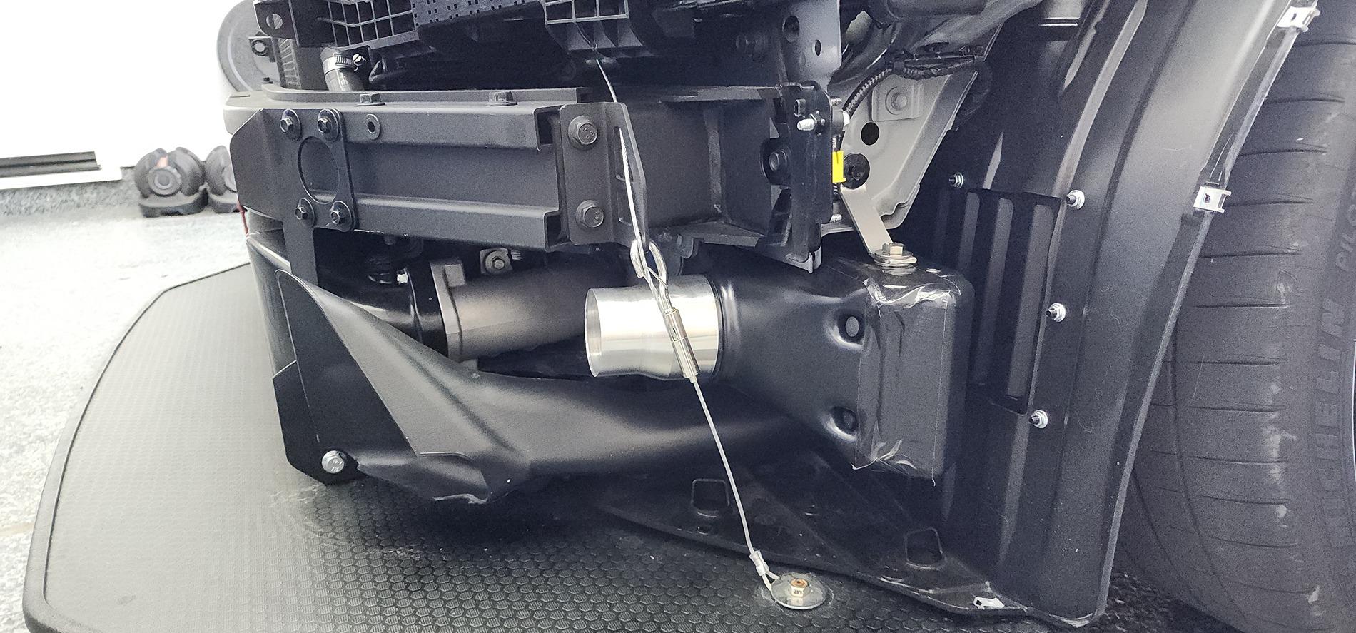

The secondary radiator is already on! Take a look at the pic with the bumper off and you'll see it right behind the crash bar.

Also went with hel because if I remember correctly (might be wrong) the greddy isn't thermostatic and hel is
11th Gen Honda Civic FL5 Overheated on Track 45deg-plate-c

I'm not in love of losing the brake duct, but I like the fans on the back of the cooler to help pull air through it
could cut a hole next to the intercooler and run a brake hose duct to the side of the wheel well?
