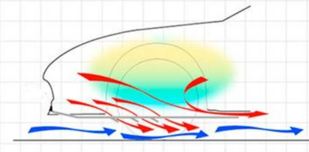

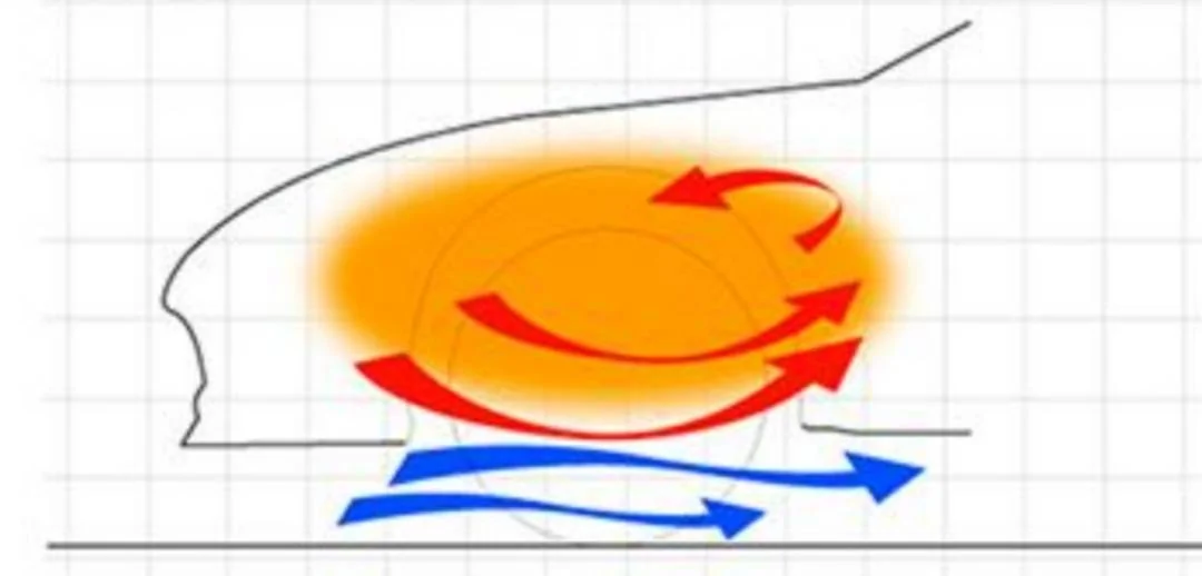

pretty cool. how would this affect the aero balance? I remember reading that Honda didn't go with a bigger vent on the hood because it added more lift than they would have liked.

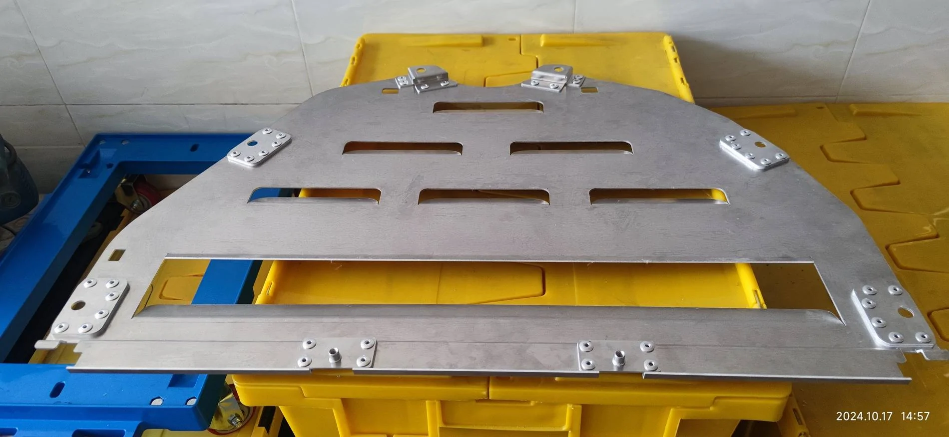

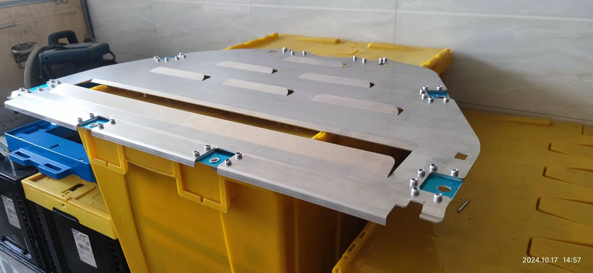

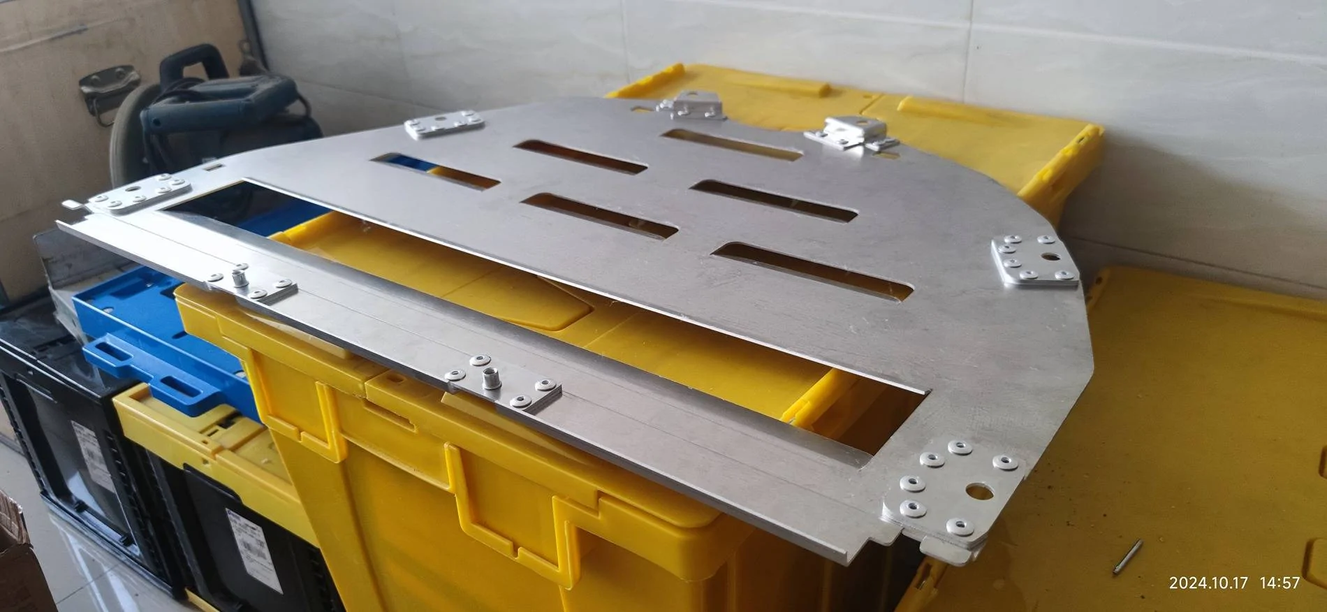

Very interesting. It would be good to measure the loss in downforce or at least measure the difference in pressures at speed with a magnahelic gauge. Also, I would suggest testing with different numbers of those vents open or closed and making it the "right" amount rather than just having as many as possible. There is probably a decreasing benefit as you add more openings.

It's cool guys are pushing the boundaries and thinking outside the box.
I'm interested in seeing the real world data on this experiment.
