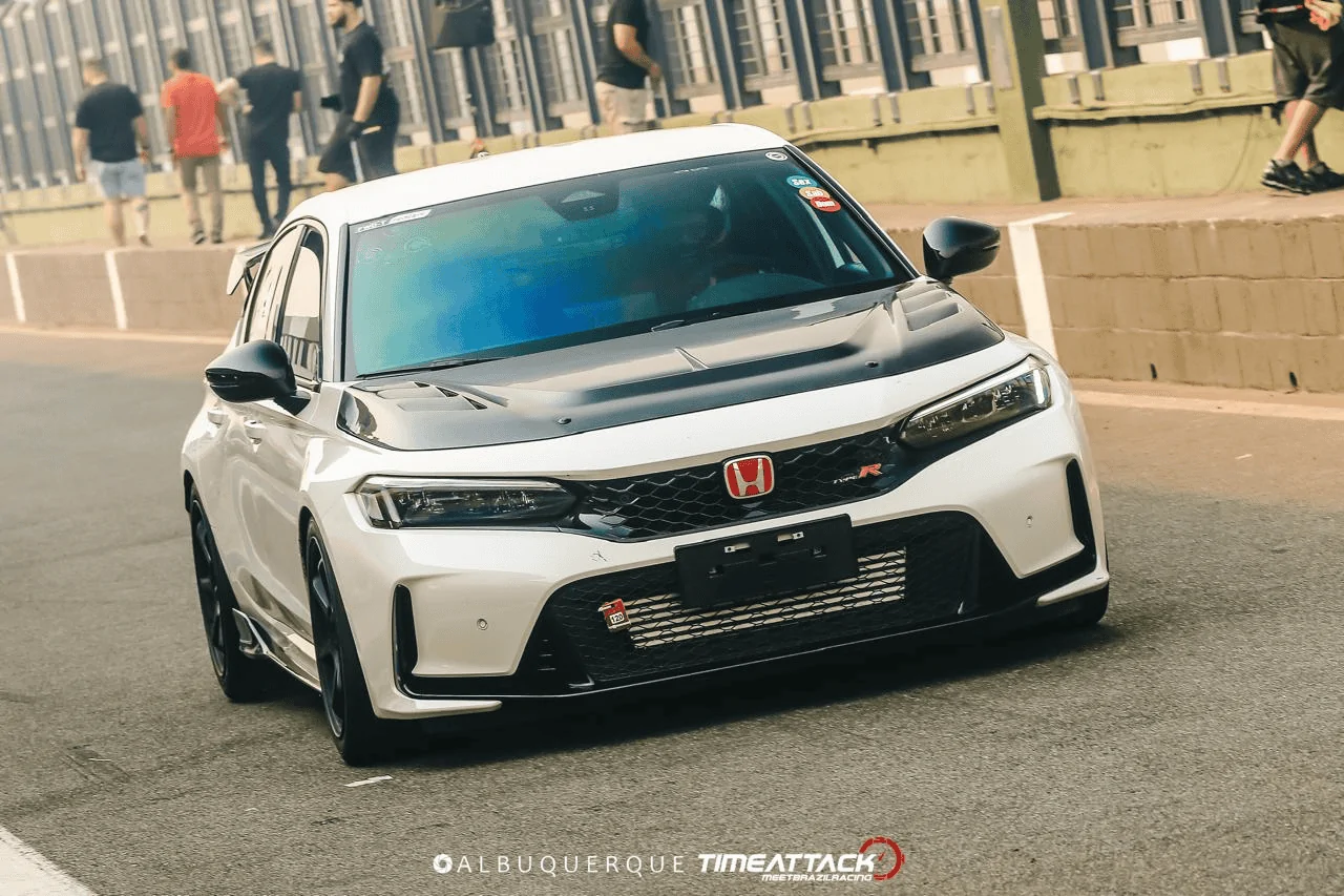

FInally I could go to the track and not overheat at any time. I didn´t do several laps in a row because my car is heading towards being a time attack car at this point so it doesn´t even make sense to waste expensive slick tires and brake pads and fuel etc.
As I mentioned at other times, I have an extensive list of mods that include:
PWR Track rad.
Hel Oil cooler kit.
Dedicated transmission radiator.
vented hood.
11th Gen Honda Civic FL5 Overheated on Track 1725326089478-u6
Now.. Every of this bits helped a lot in the cooling, specially the hood. It came last and made everything make sense because now the car cools A LOT better, and when temps rise to an uncofrtable zone, they drop from 220F (wich is as high as it gets after 2 laps under 100+ ambient temps and 160+ track temps) to 180F in 1 cool down lap.

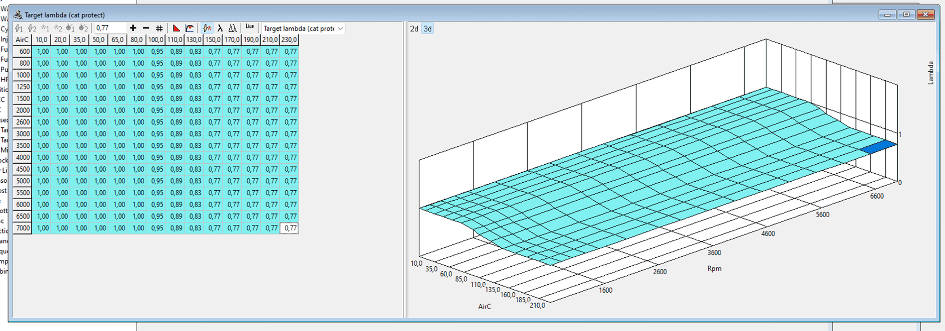

In my case I run E50 blend at .77 lambda at anything above 130% load in my track tune. I also run a very aggressive timing map that helps a lot keeping EGT´s inder control.

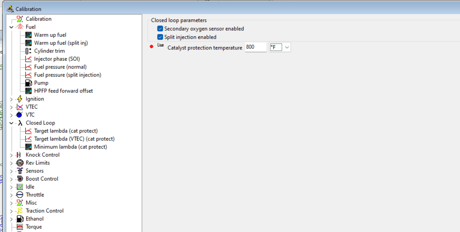

Also for those of you who use Hondata, never forget lowering the cat protection temperature to a much lower value than stock. I run around 800F on my tune to make sure that on every press of the gas pedal the car will move out of lambda 1 and make the AFRs go down quickly.
11th Gen Honda Civic FL5 Overheated on Track 1725328050253-
It´s important to select this option when running low cat prot temps otherwise the car will be pulling boost at all times.

an example of how rich I run on the track tune:

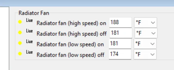

don´t forget to adjust the fans to your taste

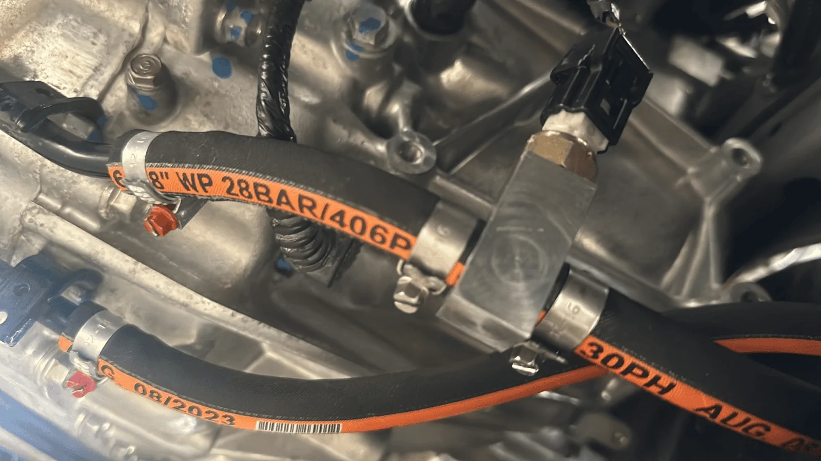

I added an ECT2 sensor to the transmission cooler line. Let´s see how hot it gets
