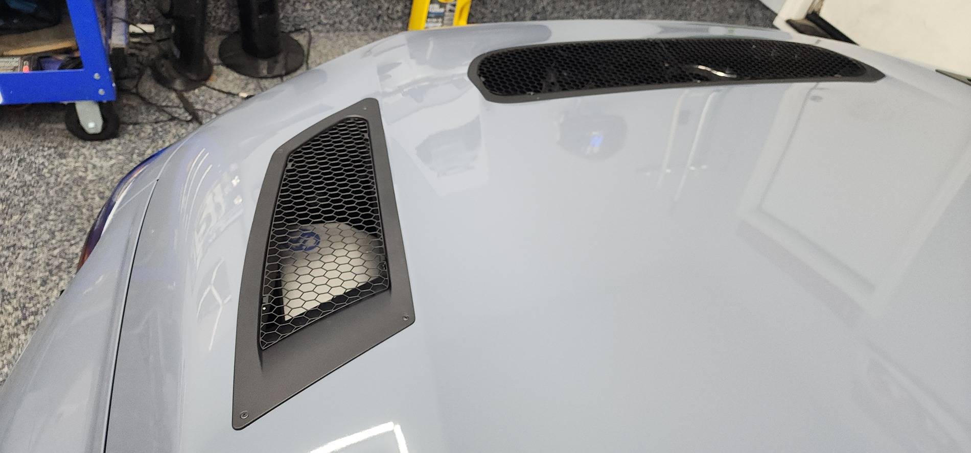

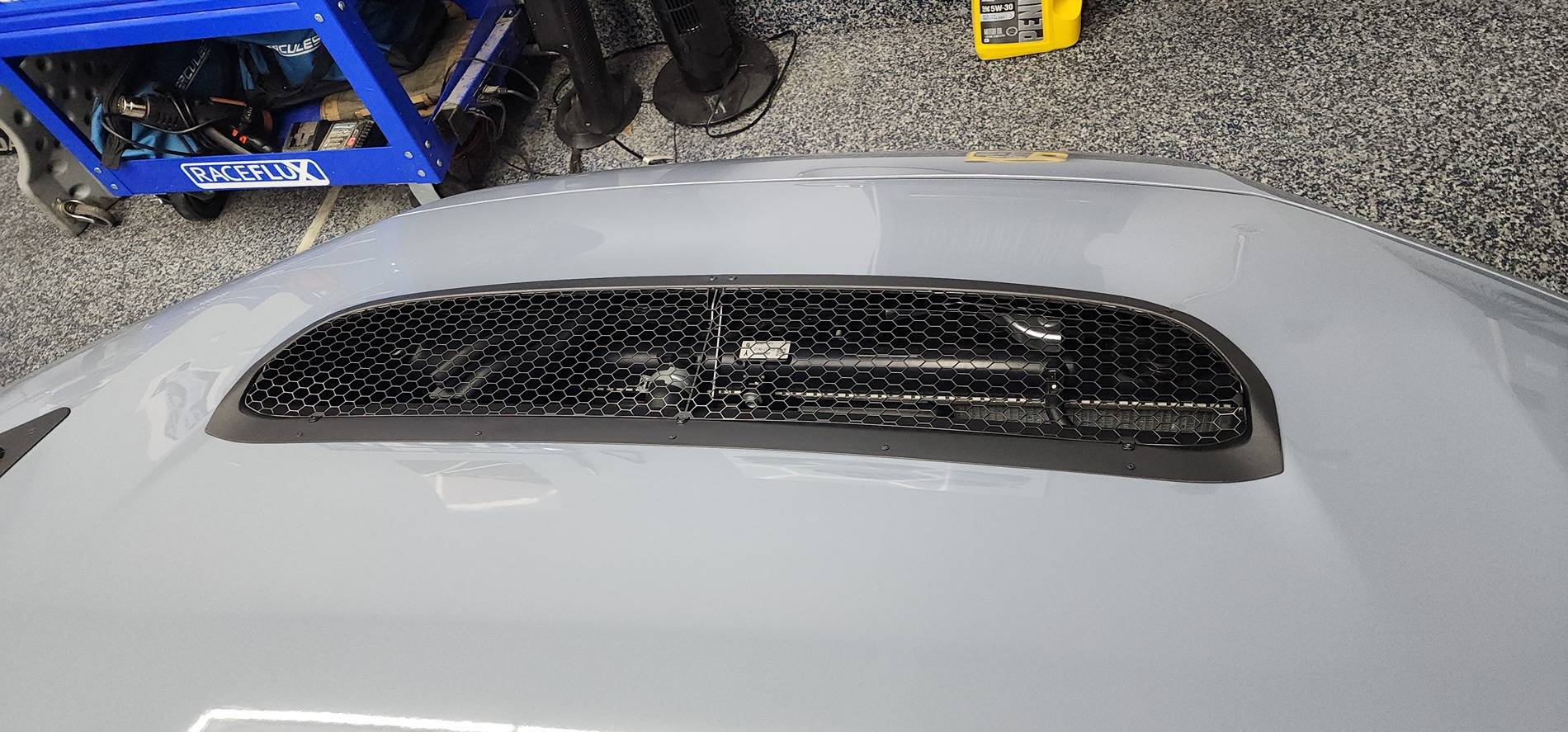

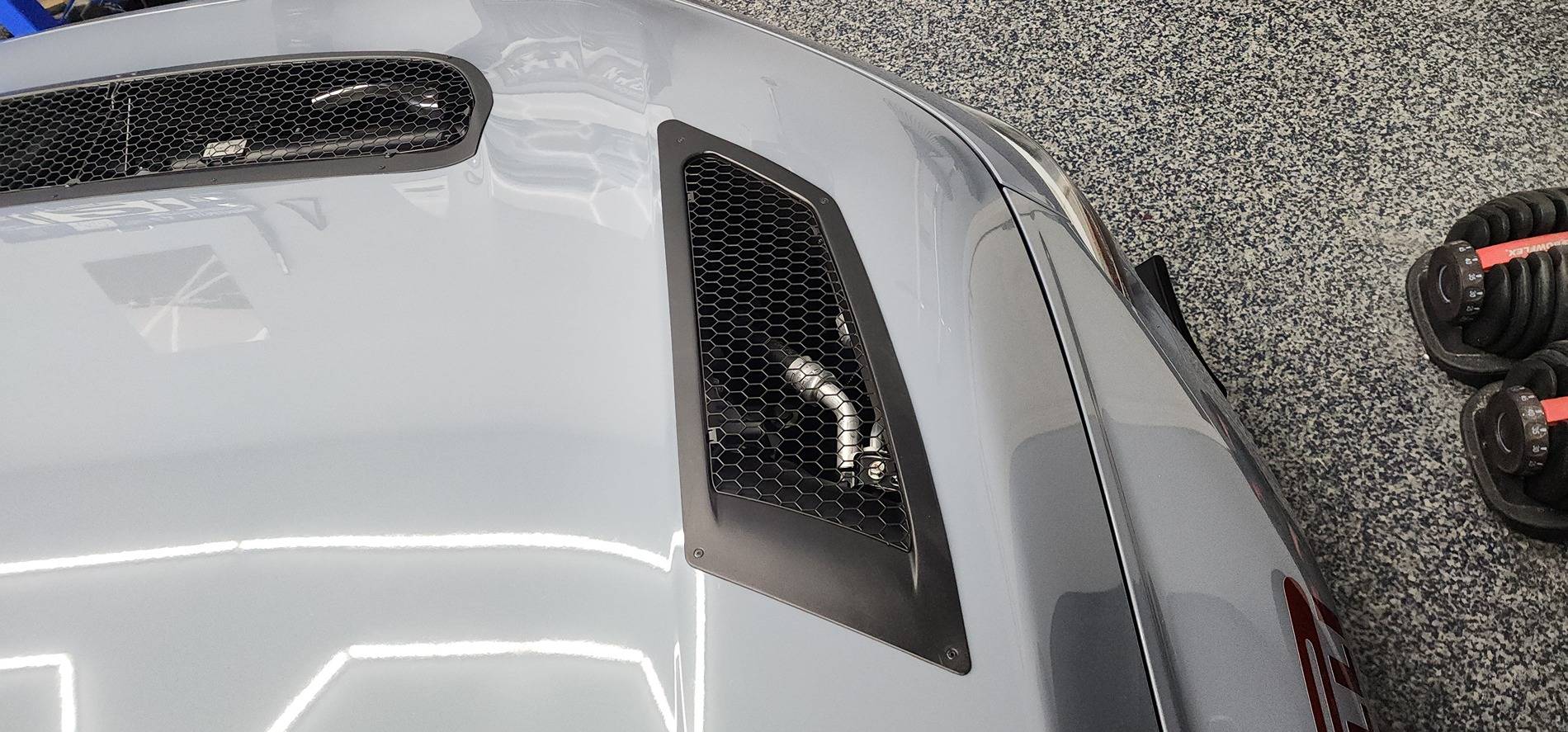

Dumb question because I think I know the answer. Any rain protection with the TCR vents?

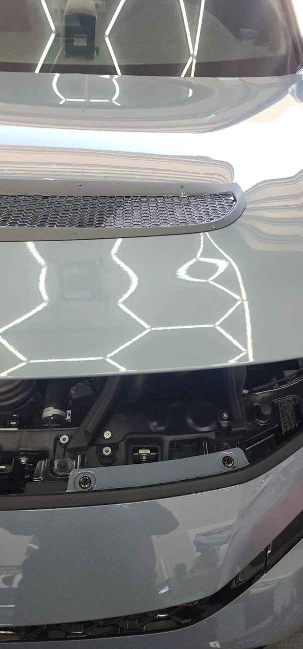

It's hard for me to tell if it is, but make sure that intake rain guard actually seals well to the intake weatherstripping. The front part of the hood is a low pressure zone, and the vent will actually suck away intake air that came in from the front grill. You don't want those two connected.

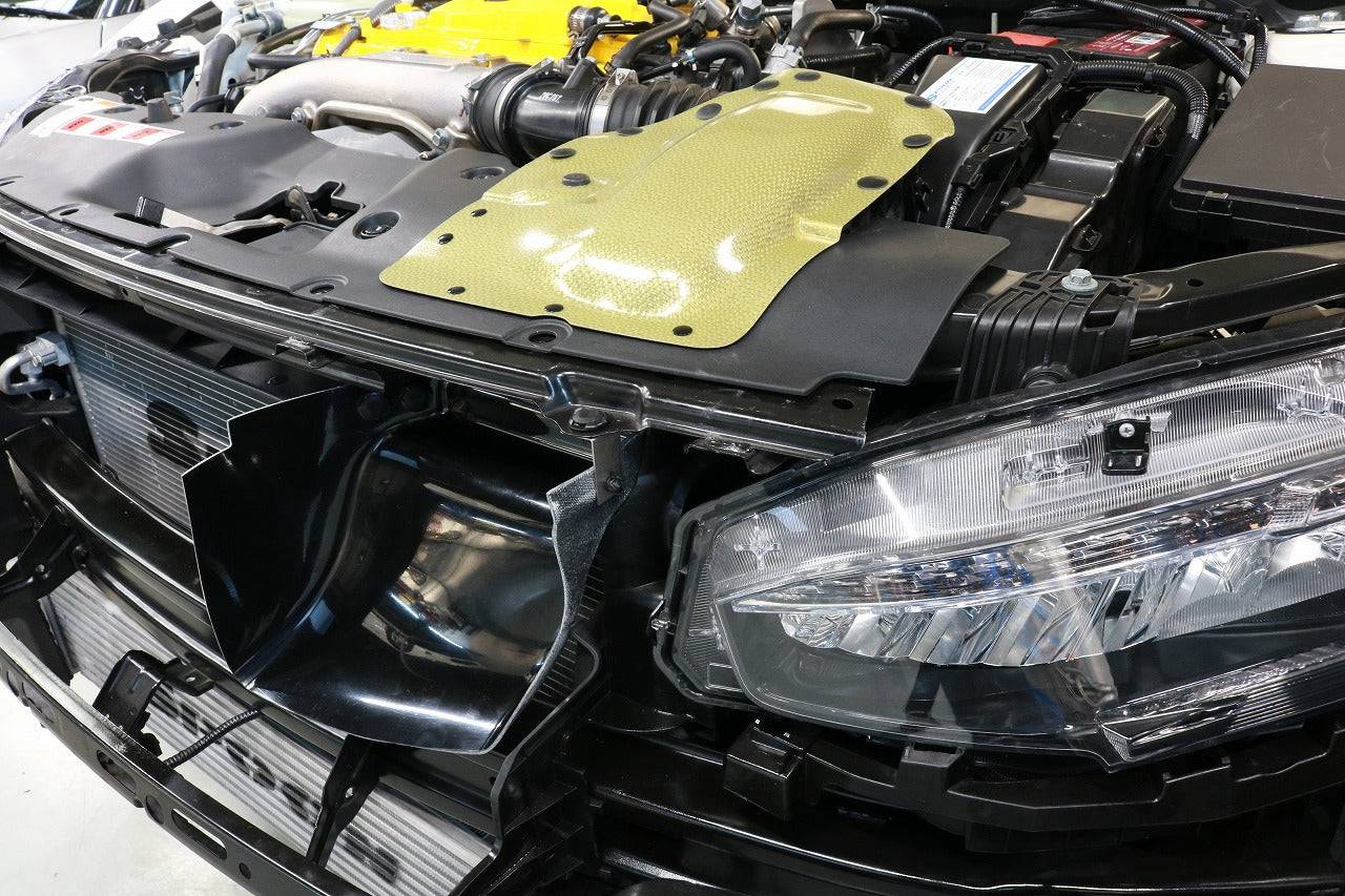

New intake concept. Trying to do my own version of the spoon fk8 intake cover.
11th Gen Honda Civic FL5 Overheated on Track received_569444749097446
11th Gen Honda Civic FL5 Overheated on Track 17228-FK8-0003_2000x
