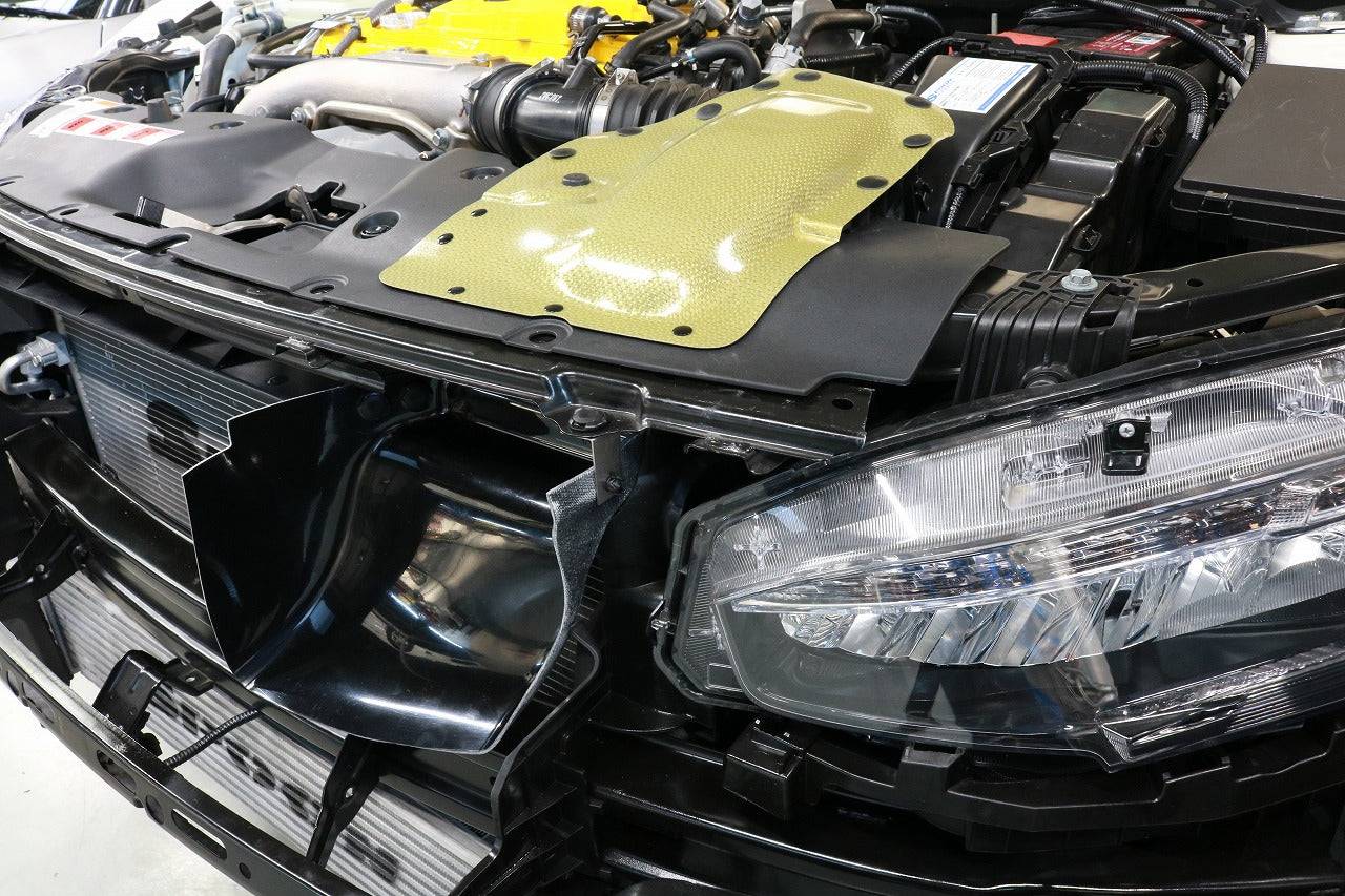

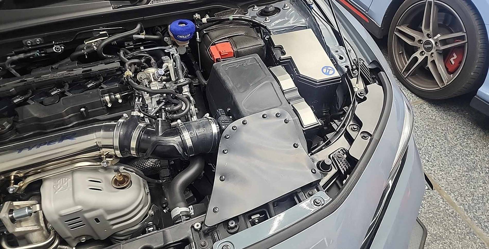

There are many factors contributing to the FL5's tendency to overheat, including the day's temperature, driving style, track conditions, and even airflow blockage from cars in front. In my experience, anything above 85°F has led to overheating, which I observed during testing at Willow Springs and Streets of Willow. I've even run my FL5 in 105°F weather. Now, my car has extensive modifications for cooling, some of which are custom and not available on the market. Since temperatures are dropping, I won’t be able to fully gauge the impact until summer returns, when I can properly test if the overheating issues are resolved.

I'm wondering if you'd be willing to share your cooling modifications?
