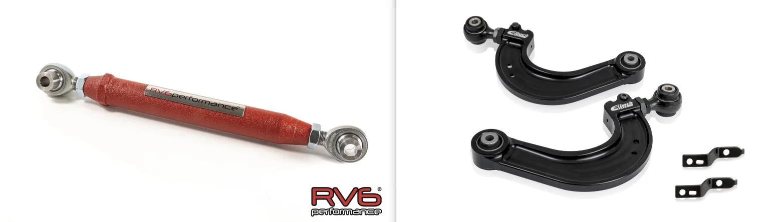

Anyone thoughts on the RV6 Camber arms vs the SPC/Eibach shaped arms?
Can you install the RV6 Camber arms without their own lower arm?
I have the Whiteline rear toe arms, and the SPC upper arm. I think the RV6 lower arm would be an easier install, but can't say for sure. I still have these parts in the box, as they were intended for my Si and I don't really need them yet on my R.

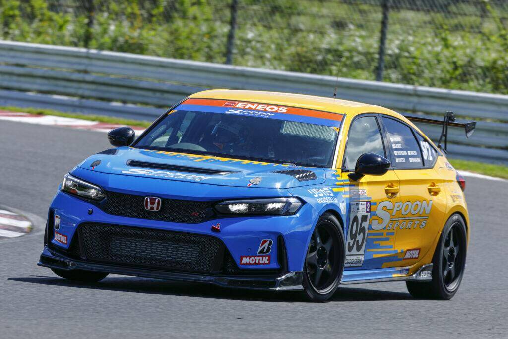

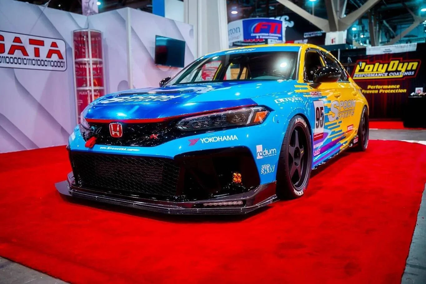

Seems like the spoon car did something similar (or maybe just doing what the dude on the other thread did).
11th Gen Honda Civic *The FL5 Track Junkie Thread* 1733152284990-lu
ah nevermind, that is old, they have moved it (probably for good reason)

their lower arm looks pimp, but that's for toe only. SCCA Tuner only allows one arm to be changed, so was going to do camber. but the two shapes are entirely different, so was wondering it it works alone.
Something is wrong on the RV6 website:
RV6 16+ CivicX Rear Lower A Control Arms (Adjust Camber) – RV6 Performance This is toe
RV6 16+ CivicX Rear Lower B Arm (Adjusts toe) – RV6 Performance This is camber
If you click on the install instructions it spells out which bar is for which adjustment. Weird that they're listed wrong. The B arm is camber, and the A arm is toe. The SPC is an upper camber adjustment vs. the RV6 B arm is adjusting camber at the bottom of the knuckle instead.
I thought so, but was like uhhh, ok....they should know better than me. Thanks for confirmation!

lol and every other reseller just picks up the wrong description. Someone on the RV6 website team messed up IMO. I was thinking how can you adjust toe from the bottom of the knuckle at the centerline of the wheel ?

btw, the SPC arms look like a difficult or tight install. The bolt on the inside of the arm looks tough to reach but it could just be my inexperience. It's been a while since I've had suspension apart.

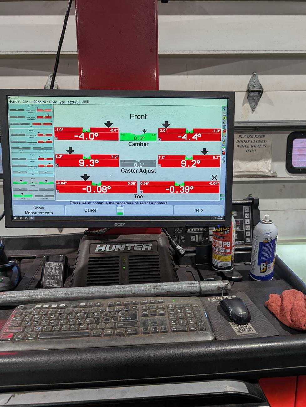

These are my pre-alignment settings after installing the EVS ball joints. The joints are currently in their most aggressive setting. I'm going to swap the collars for the middle setting instead to reduce scrub radius (per @tezzasaurusrex ). My pins are pulled and maxed out. I'm thinking -3 to -3.2 is the sweet spot that I want. 4.4 is just redonkulous. After adjustments I was able to dial the camber down to 3.7 on the aggressive setting, which is still a bit much for me. You can also see how far off the toe is after the installation...lets just say the drive to work today was...sketchy.
*Ignore the castor. These alignment heads are the clip on style, and not the style that actually grabs the rim.

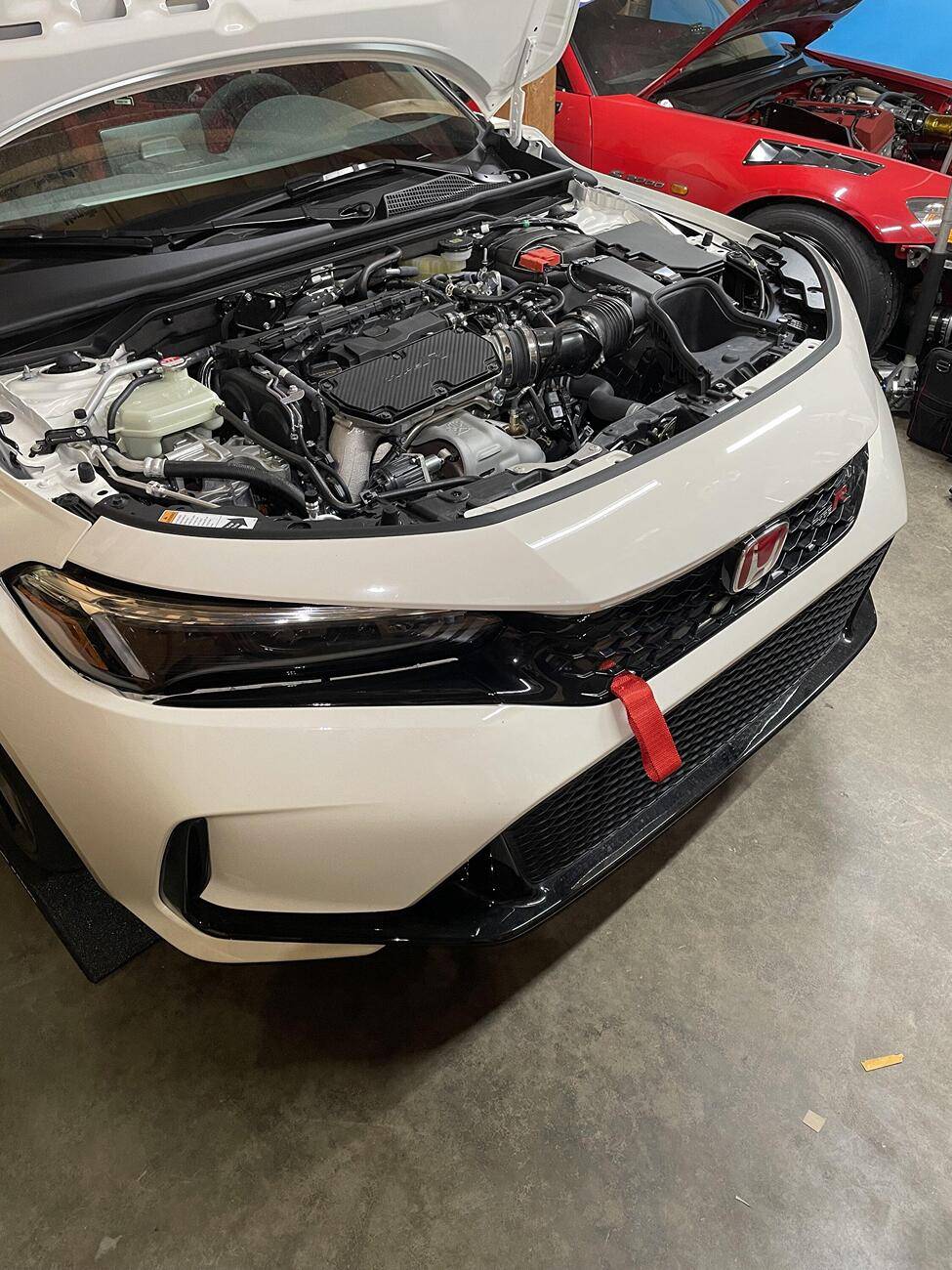

I've had my front tow strap bolted to the strut tower, I've seen it on a couple of track cars before. Hopefully it's strong enough in case I ever need it.
11th Gen Honda Civic *The FL5 Track Junkie Thread* IMG_2347
