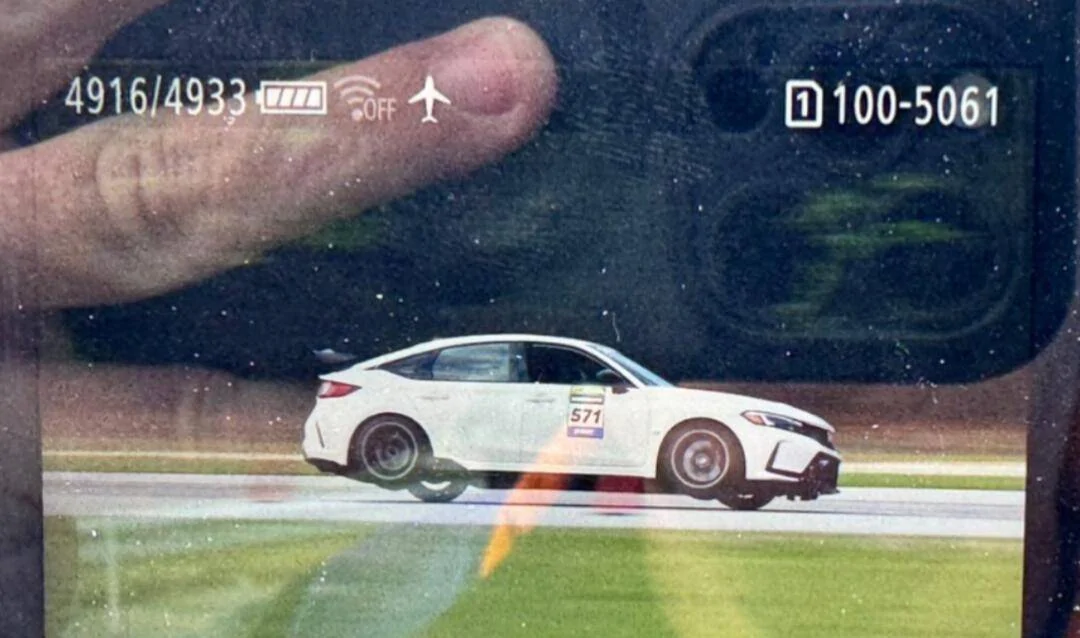

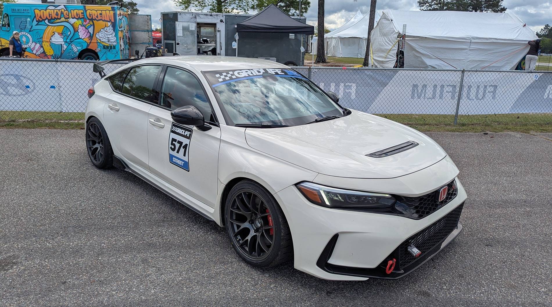

Recap from CMP Day 1:
It's a fun track! Only did 2/3 sessions today due to a storm that rolled in but the car feels pretty good, although totally unoptimized for sure.
I managed a 1:45.2, which is definitely not where I want to be, but I'm reasonably close to the other Street FWD cars (1:44.4 - Elantra N, 1:45.0 - FK8 Type R), so we'll see how the rest of the weekend goes - the AWD cars are 1:39 - 1:41, and I don't think the car/me is ready to get there right now.
Here's my fastest lap so far. I think I can probably go flat through the kink on the back straight or at least close to it, but I checked up a bit on this lap (on the next lap I shifted to 5th and took it at 112mph min speed so way faster than this, but tires were cooked as it was late in the session so the overall lap wasn't faster).
I think the car is pushing a bit and delaying my exit (although some of that is probably just FWD things), so I stiffened the rear bar by 2 settings (out of 7 total) and we'll try that tomorrow. I plan to also try +R mode at some point now that I don't have to fight the stock shocks, although the magic rear vectoring may not do much.
great driving so far!! I cut this clip for you. Keep it up. Also that EN driver I think is more pro than amateur, and in general the ENs are just usually faster in track trim. So keep going as best as you can while figuring out the car.
Also you're ahead of the Acuity FK8 which has every mod that they can outside of opening up the engine. So keep it up!!
