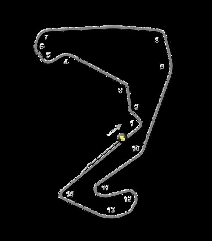

Also, I think it’s Turn 9 you jab the throttle a bit too early and it pushed you wide so you lost some time waiting for the car to settle back for full throttle. I may be wrong I don’t know that track at all lol
T9 is a non-corner so you may mean somewhere else, but I do jab the throttle sometimes mid-corner if I'm not happy with attitude of a car, hoping for it to break loose and rotate, however as the car is it's not doing that.
11th Gen Honda Civic *The FL5 Track Junkie Thread* 1000019818
For reference, I'm now almost full-stiff (I'm at ,3/4 on setting) on the Karcepts .188" rear bar and I still want more rotation everywhere.
