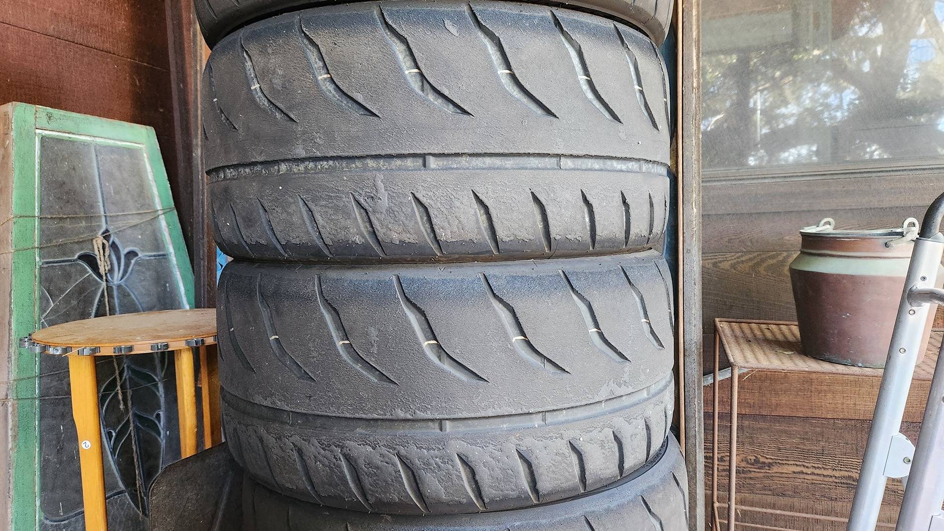

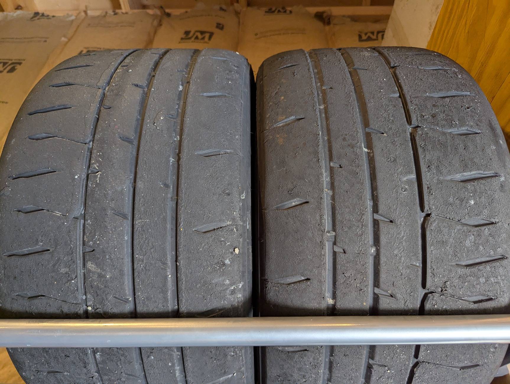

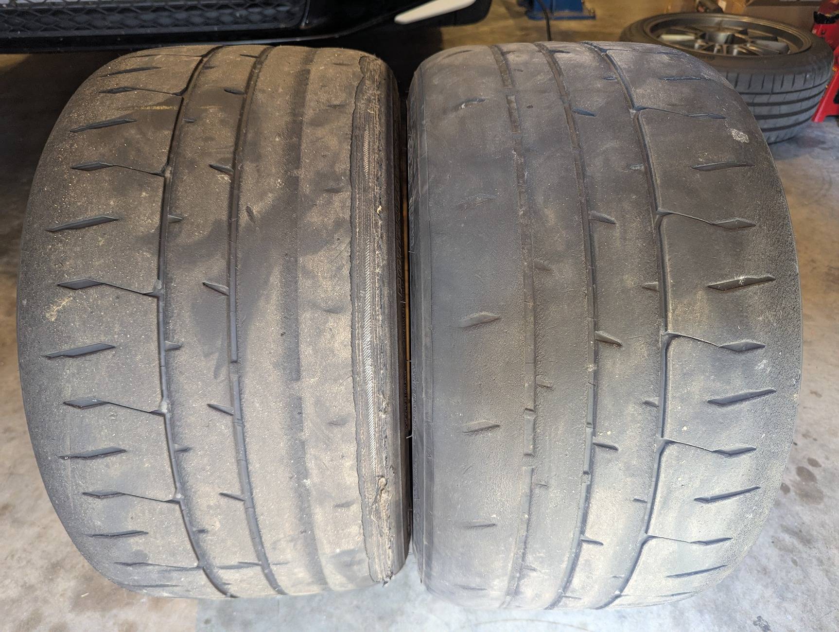

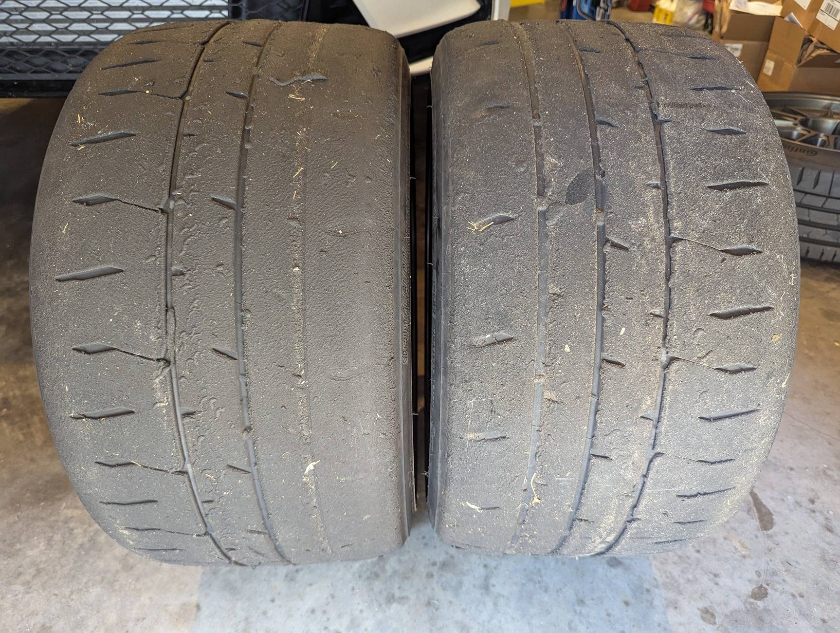

I was reviewing my tires in the garage and thought I'd share - seems like I'm moving in a good direction towards front tire life.
Set 1 - 8 Sessions on the front at CMP, ~-3.9° camber, ~375whp/tq (obviously uneven wear and all the cords showing on the inside shoulder):
11th Gen Honda Civic *The FL5 Track Junkie Thread* 1000020967
Set 2 - 8 sessions on the rear at CMP, effectively 1 session on the front at RAtl, 8 sessions on the front at GingerMan, -2.75° front camber, ~400whp/tq (just starting to wear through the inside shoulder, but uneven wear):
11th Gen Honda Civic *The FL5 Track Junkie Thread* 1000020965
Set 3 - 8 sessions on the front at Mid-Ohio, -2.75° front camber, no front bar, ~400whp/tq (more-even wear across the tread):
11th Gen Honda Civic *The FL5 Track Junkie Thread* 1000020966
Surface can definitely play a factor but it's encouraging to not burn through a set of fronts in one event - I probably won't use the Mid-Ohio set for competition necessarily but they definitely have some track days left in them at a minimum.

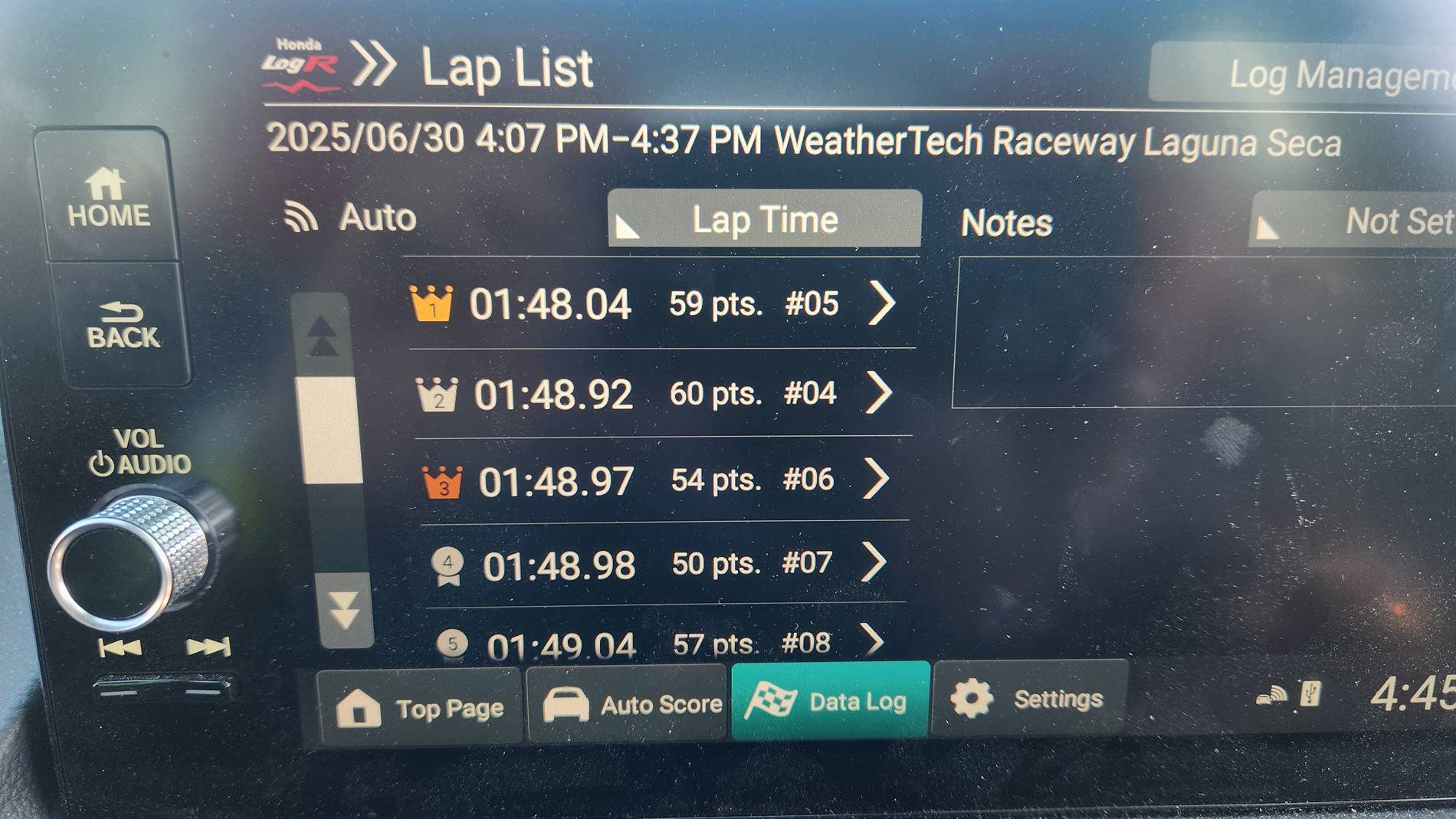

I am hoping for some help getting my 2025 FL5 dialed in for track days. My car is stock except for Honda forged 19" wheels, Toyo R888R tires, Castrol SRF brake fluid, and pins removed from the front struts, leaving 1.6 negative camber and zero toe.
I have now done four track days with a total of approximately six hours of track time at Sears Point, Willow Springs and Laguna Seca. I had no brake problems until this past Sunday at Laguna Seca. I would guess that was because there are only a couple of hard braking zones at Sears Point and at Willow Springs, and there is plenty of cooling time in between them, but there are four at Laguna Seca, two of which come within ten seconds of each other.
On Sunday, the "Brake System" warning light came on halfway through each session. I didn't notice any softening of the pedal or other problems, so I kept going (at 73 years old, you don't have that much to lose), but after the last session, when I pushed the hardest (see lap times below), smoke was pouring out of the front brakes when I pulled into the paddock, even after one half of a cool down lap (they throw the checkered flag at the Corkscrew so you don't get a full cool down lap). I dove around the paddock slowly for a couple of minutes and the smoke stopped, and the brakes feel fine now.
Should I be worried about the "Brake System" warning light, or is it probably just overheated fluid/pads?
Are there any brake pads that will stand up to track use, but still be OK for the street? I am not mechanically inclined and not up to swapping pads for track weekends.
One last question: My oil temperature went as high as 273 degrees. Can I continue running like that, or will it damage the engine?
Thank you for taking the time to read this.
11th Gen Honda Civic *The FL5 Track Junkie Thread* Laguna Seca Lap Times 6.30.25

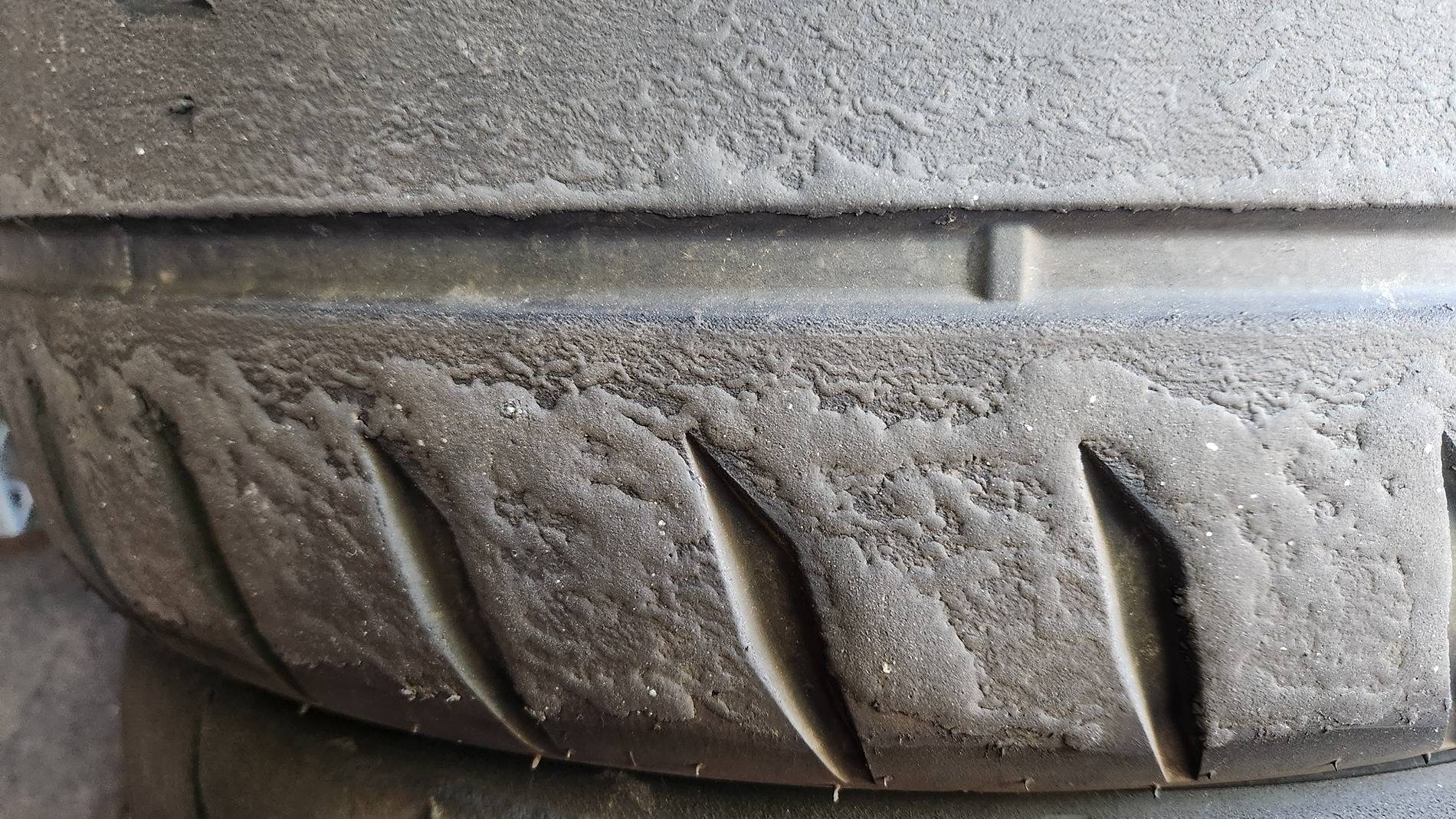

I just took a close look at my Toyo R888R tires after 3 track days and a 300 mile drive home and noticed something unusual on the inner tread of the rear tires. It looks like the rubber melted, but the fronts do not show this and I am pretty sure that they got a lot hotter than the rears, taking the brunt of braking, accelerating and turning. The rear alignment settings are stock. Has anyone else seen anything like this?
11th Gen Honda Civic *The FL5 Track Junkie Thread* 20250723_162621
11th Gen Honda Civic *The FL5 Track Junkie Thread* 20250723_162641
MooMoo
Apr 6, 2024
1,478
1,542
this is what they call OPR (other peoples rubber), basically you picked up other peoples tires as your tires got super hot, totally normal and usually always in the back because the fronts scrub off as they have to do twice the work :)
Rfpauly
Apr 7, 2025
49
2025 Honda Civic Type R
Thank you. Do I need to try to cut it off, or should it wipe itself off at speed?
MooMoo
Apr 6, 2024
1,478
1,542
They are a huge pain to remove since they are now cold. There is a machine that removes em. Best way to get rid of them is to swap wheels back to front and they will scrub off.
