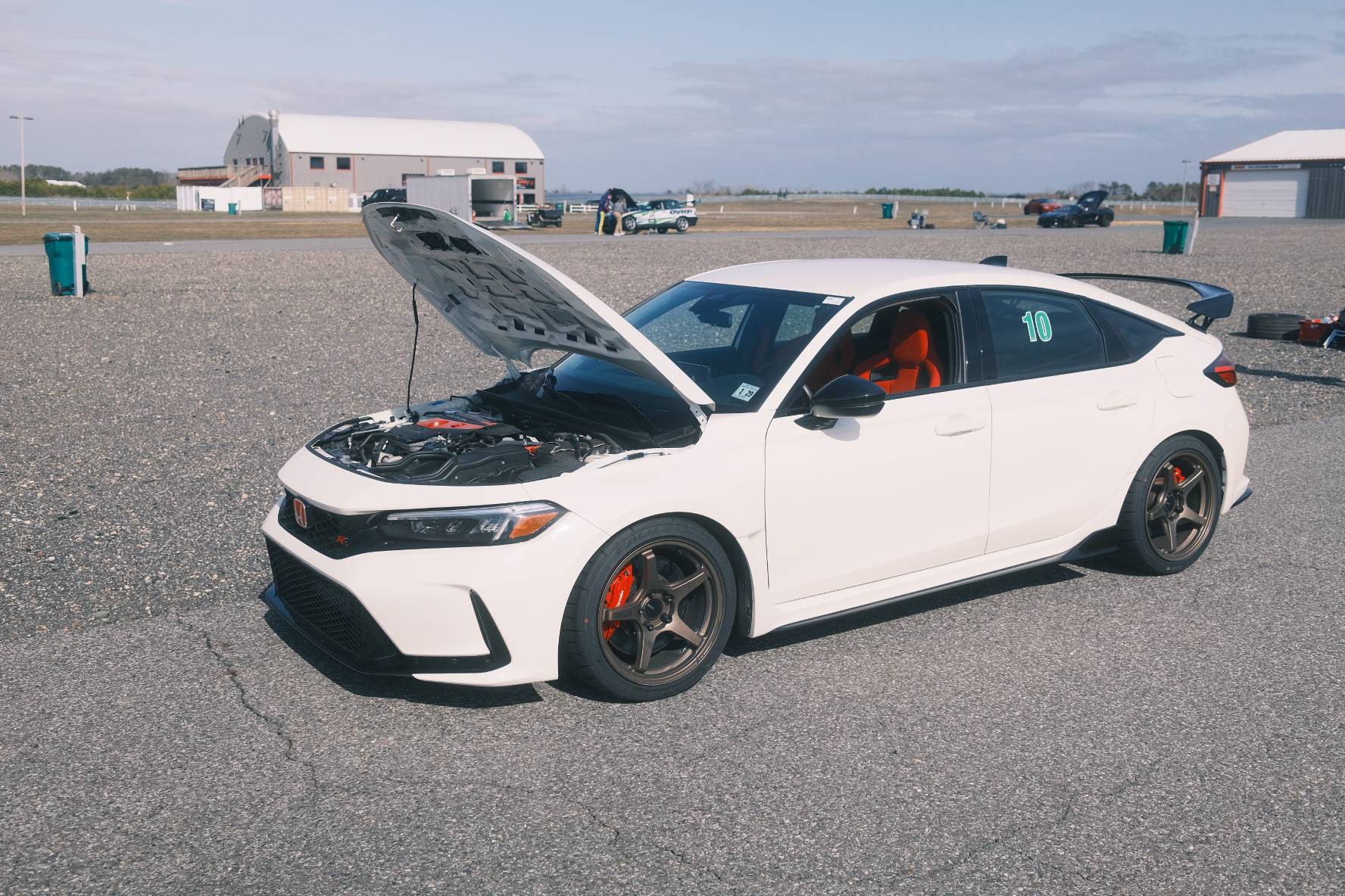

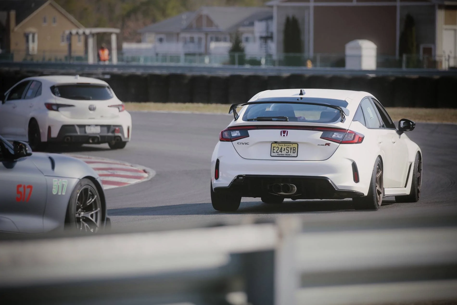

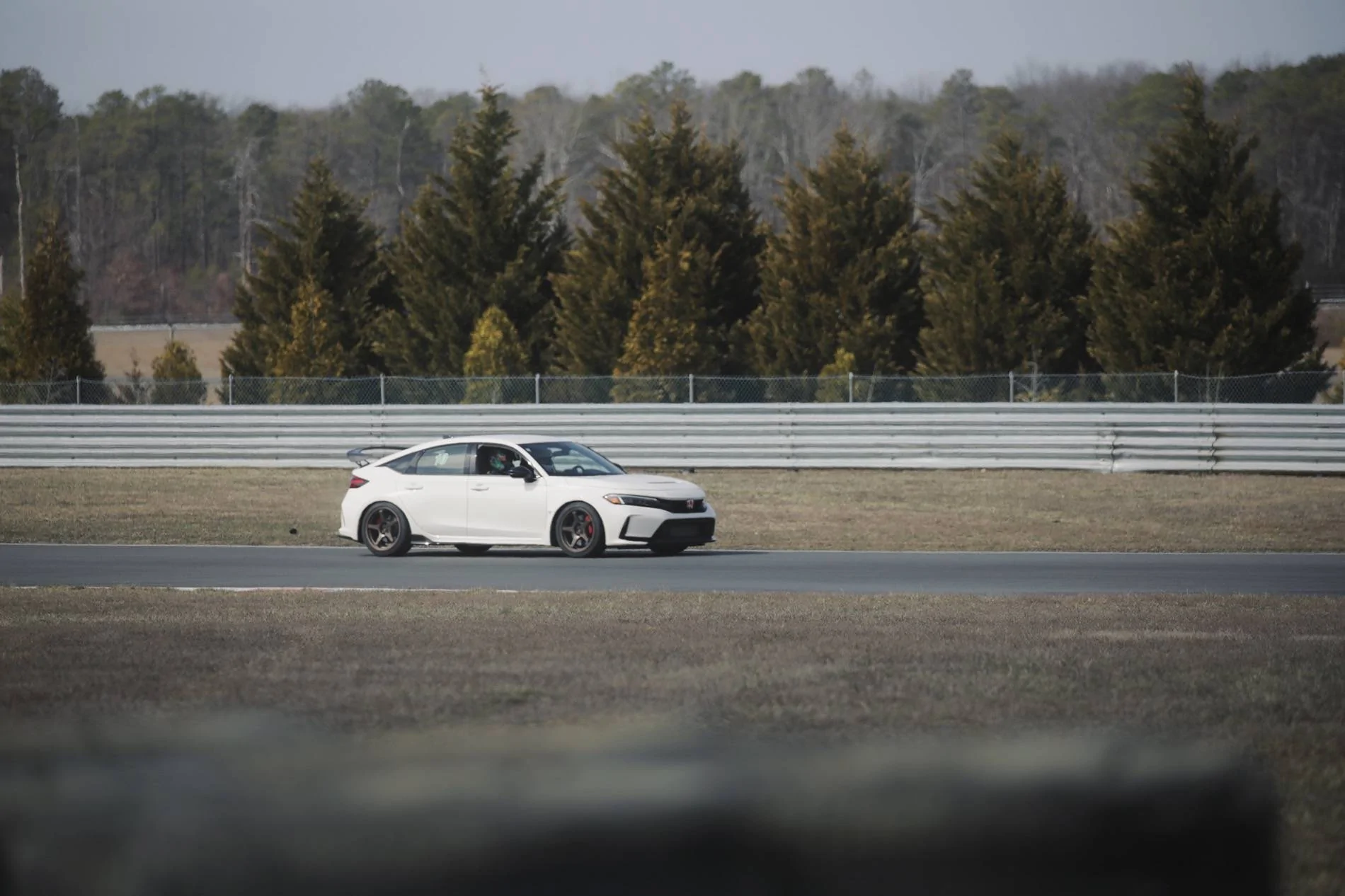

Successful first track day here and can’t wait to do another! I’ll share my thoughts and setup:
For track specific mods I went with rt615k tires on 18s, Paragon P3 pads front and rear, SRF fluid, Type S damper module with eibach pro kit springs. As a novice I don’t think that you really NEED anything more aggressive than this for tires and brakes. The car felt really good in the corners, plenty of power and brakes felt strong. I think it’s more than quick enough with this setup for a novice, when you get a few corners right trust me you’ll be going very fast. I think damper module also helped soak up those curbs since I was in R mode. New guys don’t forget to keep an eye on those tire pressures! Don’t think that’s talked about much here but it’s important. Bring em down to mid to low 20s psi and they’ll climb up.
Which brings me to my first point. I was so pleased and frankly amazed with how the car performed and allowed me, as a novice, to gain tons of confidence in a relatively short period of time. The FWD is pretty easy to put the power down but I also used R mode without changing any traction settings and as I got faster and faster i noticed how it helped rotate the car especially in tight turns or oops moments. Same with the rev matching, it allowed me to get fast very quickly because the car was never unbalanced by a poor heel toe downshift. I was able to focus purely on braking and turn in. I know some people reading this might think it’s cheating or to many aids but if you haven’t done it before, trust me it ain’t. And when you get better, go ahead and turn stuff off. But I was battling some very fast cars by session two onward and it was fun as shit!
Fatigue is REAL. I got very sloppy when fatigue kicked in and got some serious arm pump. 35m sessions are no joke. Maybe I was gripping the steering wheel to hard or seat not holding me in, not sure. I also found that I was very precise when no cars were around but once those dam supras came flying up behind me it was all thrown away and I got sloppy and/or pushed too hard. Learning to stay focused at speed and not let your mind trigger fight or flight is tough lesson on the track (not driving in your mirrors) Your ego will be checked.
Overall great experience, I was happy it was not a very rigid environment, my fiancé was able to hang out with us all day in the paddock, drivers meeting, track walk, even the class room and take pictures around the track. I also got to ride in my instructor Tim Hannen’s E36 race car and I think it changed my life. Mind bending grip.
