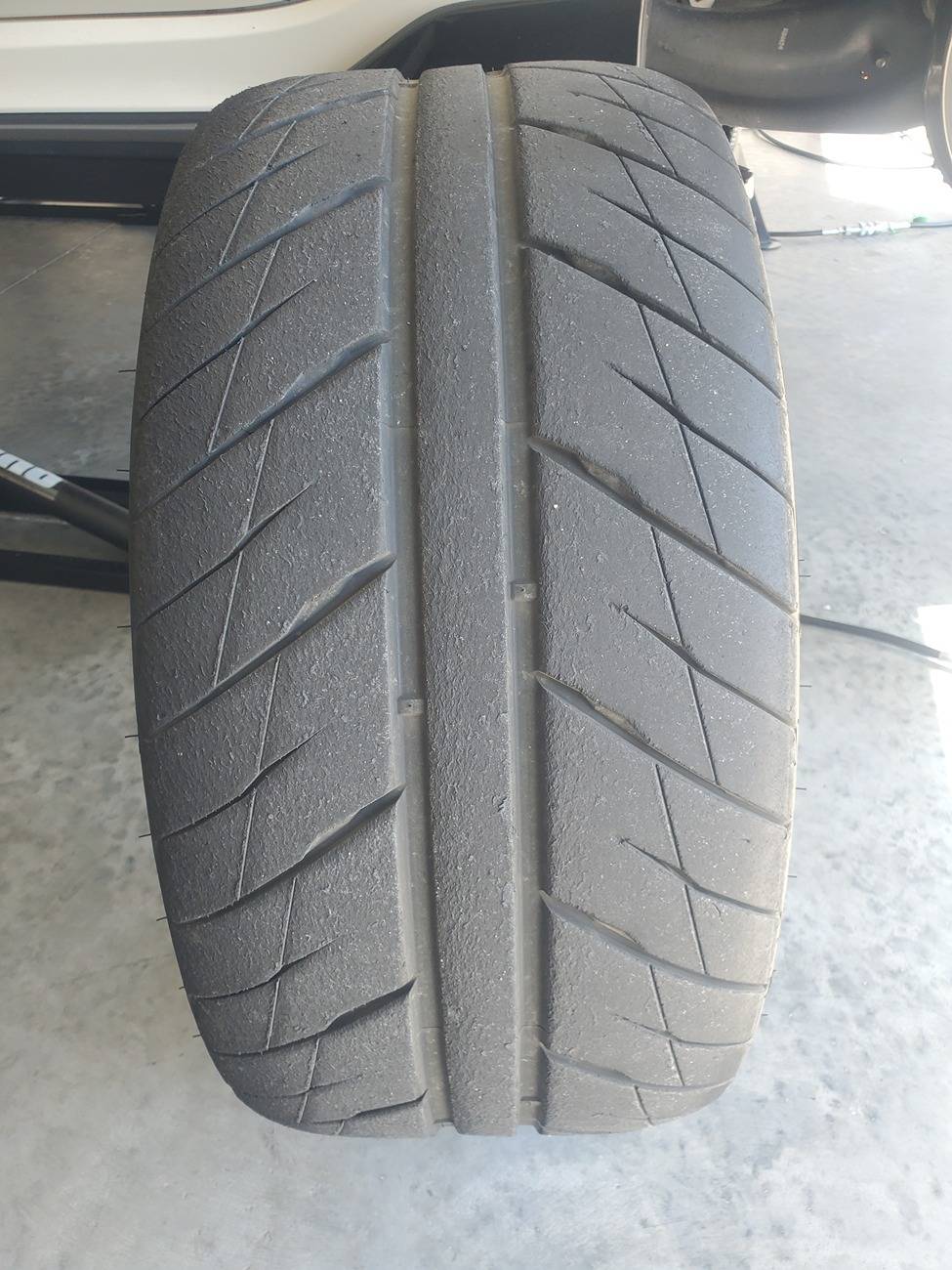

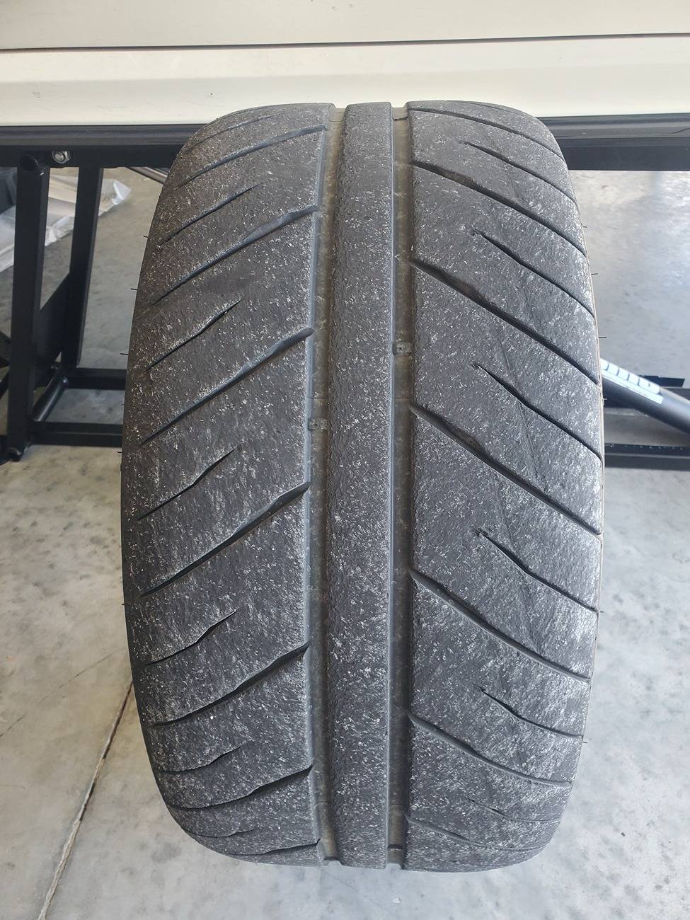

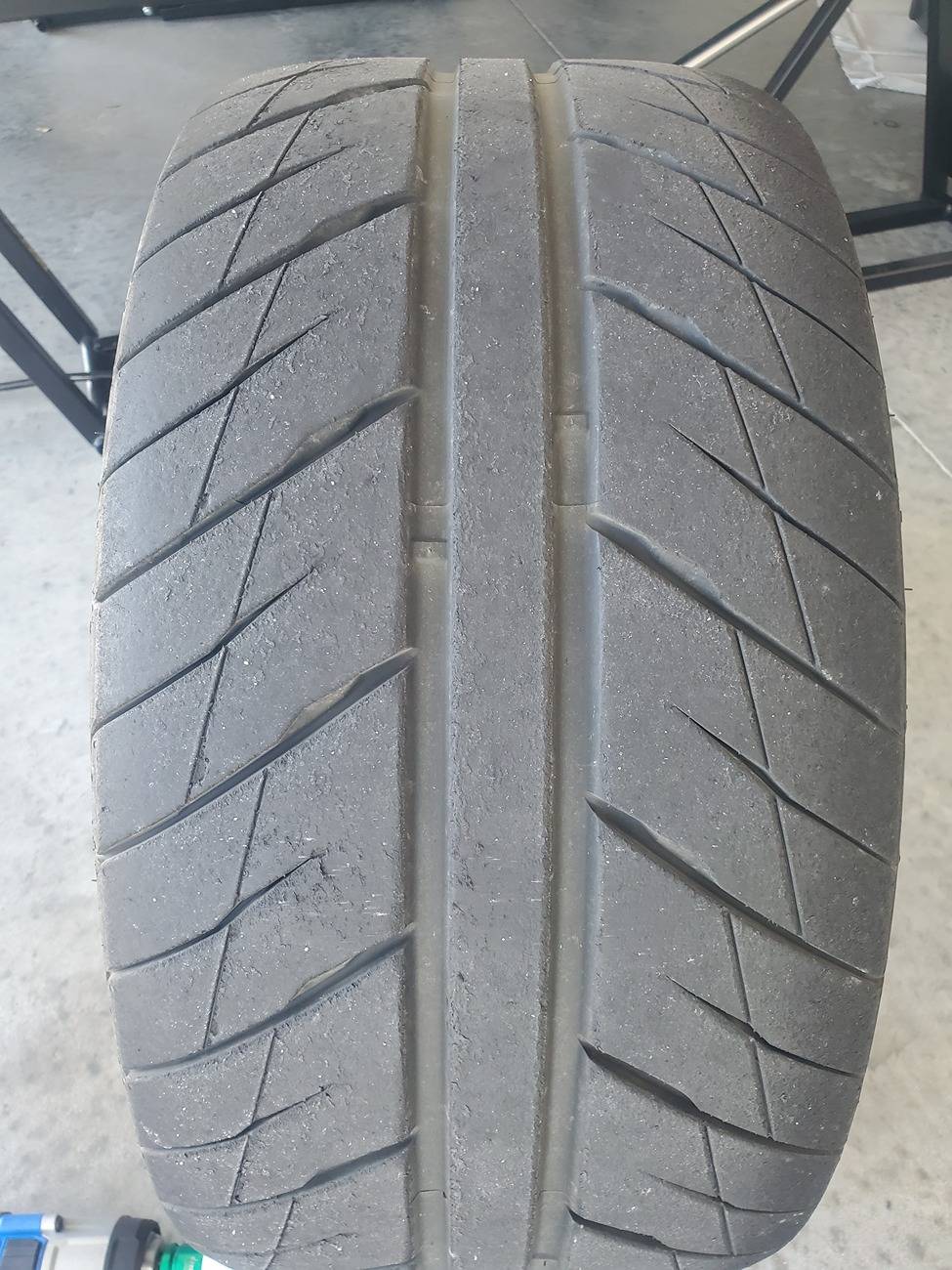

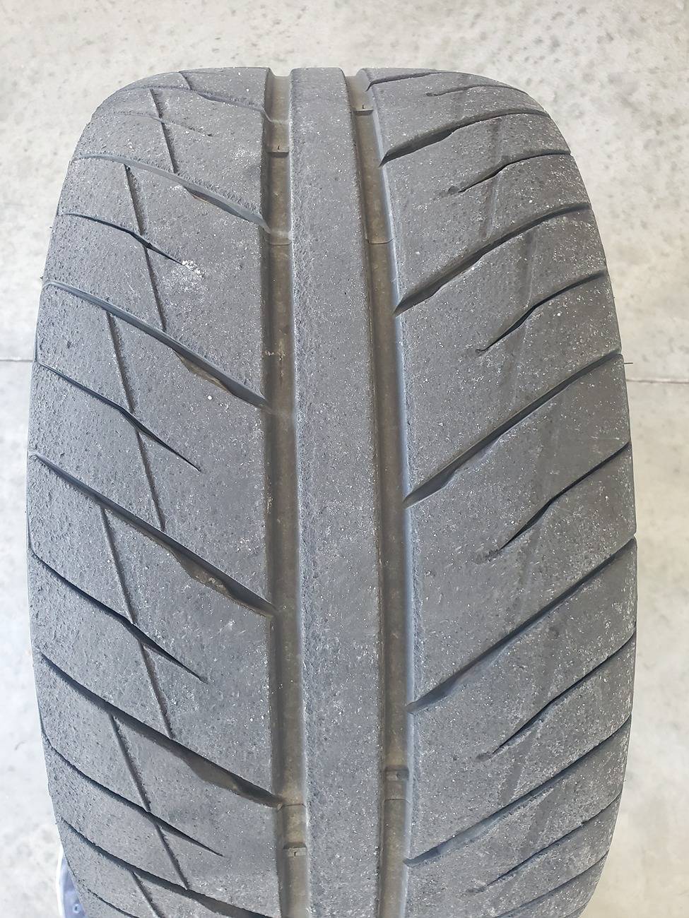

Just got done an oil change.
It does seem like I melted the paint brakes from the last time I was out. The good news is that its entirely superficial. Everything looked fine. I can start to see spider webbing forming on my front right rotor.
Here are my tires. To me they dont look bad but when I look closer I can see the scuffed rubber which I'm assuming is normal. I just don't know exactly what to look for when checking tire wear. They look fine to me despite the rough ride (but I think thats from wheel weights falling off)
Front Left
11th Gen Honda Civic CIVICXI *NOVICE* Track Thread! 20250418_110006
Rear Left
11th Gen Honda Civic CIVICXI *NOVICE* Track Thread! 20250418_110029
Front Right:
11th Gen Honda Civic CIVICXI *NOVICE* Track Thread! 20250418_110051
Rear Right
11th Gen Honda Civic CIVICXI *NOVICE* Track Thread! 20250418_110105

They look fine to me!
