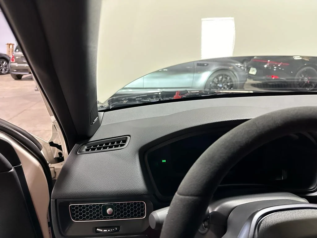

P3 will bring a solution to market in the next 30-60 days or so. If you're unfamiliar with P3, they manufacture custom, integrated gauge solutions. In the interest of full disclosure, I have no firsthand experience with their products; however, I would investigate this further if I needed a gauge for this car. Anyhow, the FL5 gauge that will be available soon will be located in the defrost vent to the left of the steering wheel (see picture). My understanding is it will not take up all of the vent space. Also, here's the link to the gauge solution they have available for the 10th-generation Civic.
The P3 gauge will be a good option if they offer the version for external sensors. The OBD2 version will just give the estimated values too. Hopefully they offer both for the FL5.
An analog version will be offered with two inputs. You will have the option to run a sensor for oil tempurature if you wish.
Jester04
2,043
2,687
Yeah if they keep those 5v inputs it will be a clean way to run it with an almost oem look.
