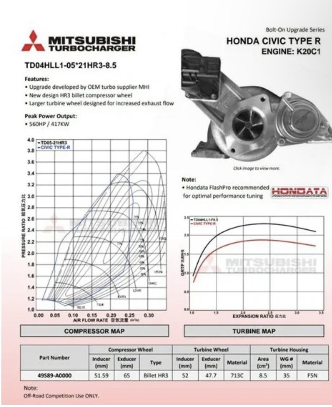

Yeah its hard to pin point for sure even more so without actually breaking down the turbo and seeing what wore out. But over spinning a turbo is a silent killer that most people don’t take into consideration. That is why turbo pressure maps are so important.
on this turbo compressor map you can see how much more broad the MHI stage 2 turbo is regarding working pressures.
Yup. I just don't believe an overspinning turbo would cause the AN lines to let go. Rather the AN lines loosened off and let go, followed by overheating turbo which went into meltdown, rubber seal on BPV melted, overspin and overheated turbo destroys bearings and kaboom.
Have there been reports of the OEM BPV failing on stock or MHI stage 2 turbo's? Assuming most people are running the OEM BPV on their MHI stage 2.
Not that I have heard so far. But from experience in other platforms its good practice to replace then when pushing more boost from factory.
And yeah I agree, the line has nothing to do with the overspinning. That is a failure/install error.
