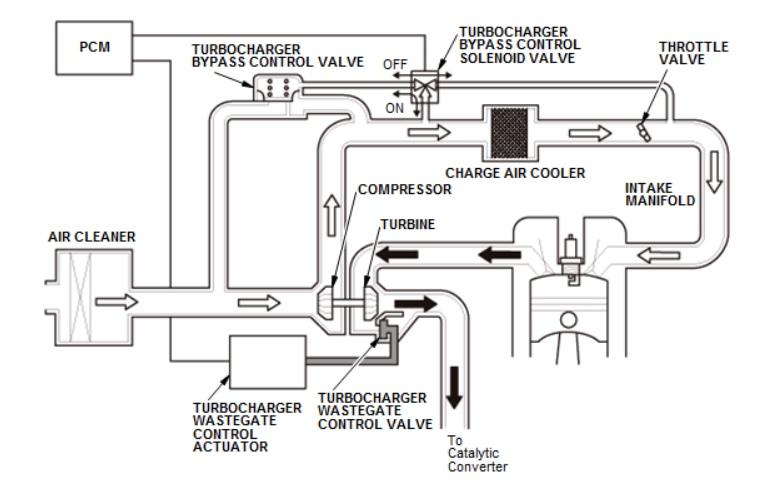

I'm not convinced we've been given the complete story on what happened on Gridzilla's car - we know the coolant lines blew out which would have cooked the turbo, is this then the cause of the failure of the BPV? Rather than the BPV failure/Overboost causing the AN lines to blow out, cause I cant see that happening... and without seeing the logs we will never know...
A turbo without a coolant feed will absolutely cook everything in its surrounding area including the wastegate/BPV etc.
The thing about these kinds of youtubers who are being sponsored is that there are always other interests involved, and unfortunately these "other interests" cover the real truth...
For reference here is the turbo schematic of the FK8 (indentical to the FL5):
11th Gen Honda Civic FL5 Overheated on Track IMG_2653 Turbo Schematic
The vehicle has two systems run via the PCM to control boost, one being the BPV and the other being the Wastegate Actuator. So even if the BPV was to develop a small tear, the wastegate actuator *should* be able to manage the boost demand by bypassing all the exhaust gas and slowing down the turbine.
Sadly this won’t work, because what happens with a tear like that is more related to turbo shaft and wheel speeds than actual boost. The wastegate will actually close more to try to maintain the boost where it wants since with the leak it will just keep bleeding the pressure. These cars don’t have a turbo speed sensor that I know of to monitor this parameter. So the turbo will be overworked and will spin to uncontrollable speeds and the excess heat produced will just make the turbo die.
The same thing can happen with a blown off charge pipe. If you try to boost the car the turbo will just spin too fast and kill itself.
That makes sense now that I think about it.
I do still think its a big question mark on the root cause of the failure though, bit of a chicken or the egg type situation.
